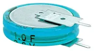

The plates of "large" capacitors often receive charges exceeding 1 coulomb.
This 5V capable, 1 Farad capcator is about 5mm thick 20mm diameter and costs a few dollars Cornell-Dubilier EDC334Z5R5V
However it's not an isolated charge, one plate of the capacitor accepts a charge as the opposite charge is induced in the other plate (the plates are convoluted structures internal to the case pictured)
