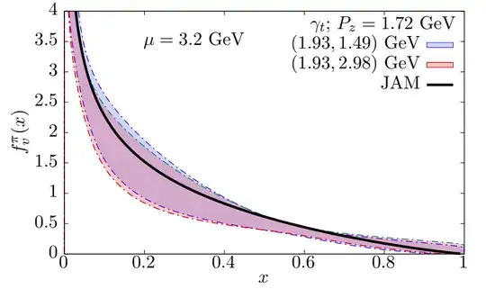

However when I consult some recent calculations for the valence PDF for the pion [source], the result is not even close to being symmetric around $x=1/2$.
Should the valence PDF of the pion be symmetric about $x=1/2$, or at least peak there, for any value of $Q$? Is there any way to understand how DGLAP is "physically" affecting the valence PDF? I just want to understand the above PDF a little better.
