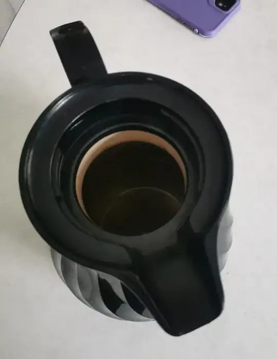

Friends of mine observed an effect recently whereby boiling hot water was placed in a thermos, only for the thermos to become difficult to open (an apparent suction effect) after about 30 minutes.

I've attached a picture of the particular thermos this was observed with, if it's helpful.
Thermos
