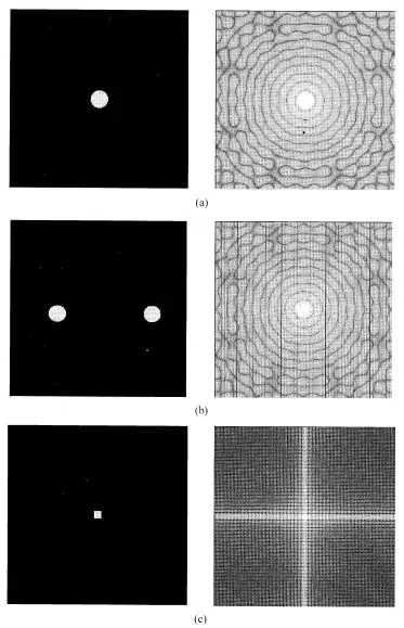

I have some questions about this interesting concept I came across about 2D Fourier transform, please...

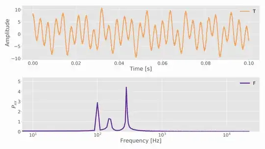

Firstly, the Fourier transform of a 1D signal (such as a sound recording) is as follows:
The first picture is a graph of the real sound file, and the second picture is the sorted frequency bins of the analysed original recording. Although the the graphs are often plotted next to each other, the frequency domain graph really is not at all related to space dimensions, as it has no relations at all to the physical shape of the sound waves (or images file) etc. It is just a histogram of the strength of the different frequencies found after analysis, from bin 1, 2, 3... into a chart.
But, when we come to the 2D Fourier transform for images, suddenly I have trouble even picturing what this might possibly mean?
What is meant by the Fourier transform of a 2D signal? Do we take many 1D Fourier charts in the x-direction as before and do another meta Fourier transform in the y-direction on these frequency charts?
Since frequency charts are not even about spatial relationships, but really about histograms of tabulated frequencies, what does the frequency picture even represent? How to calculate the color value for each of the point $(x,y)$ in the frequency image, and what does the $x$-axis represent, what does the $y$-axis represent in this frequency image?
EDIT: Forward Fourier transform results

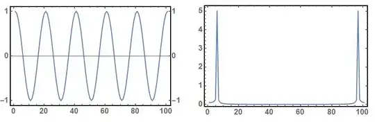

Here is a cosine wave, $\cos(x)$, 5 periods discretized into 101 points (since images on your computer are discrete, let's work with discrete data here). The x-axis is just the point number, not $x$. To the right is the absolute value of its discrete Fourier transform, $F(\cos(x))$ (I used the Mathematica default options for this).
We can interpret the peaks in this transform as the frequencies which comprise $\cos(x)$, one at positive frequency, and one at negative frequency. Since there are five periods within the range on the left, the transform peaks occur on the fifth points from the left and right (actually, the sixth point from the left including the zero frequency point). If the wave had a higher frequency, then there would be more periods within the range, and the transform peaks would appear further from the left and right, respectively.

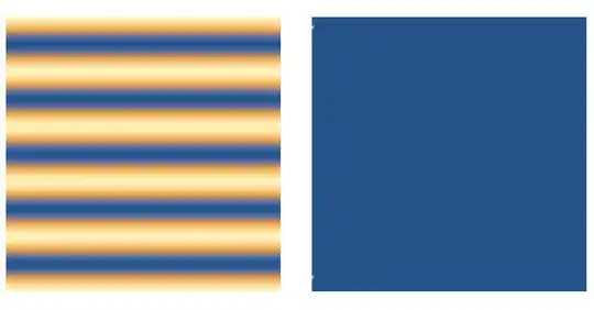

Okay, now here's the 2D version of the same plot, along with the 2D Fourier transform of the image (absolute value, again):
You'll notice, at the very bottom of the transform image, two blips corresponding to the peaks in the first image. How do we interpret this? Well, again, the peaks represent the frequencies comprising $\cos(x)$. Since now we're plotting $\cos(x)$ in the $x$-$y$ plane, the fact that the peaks occur at the very bottom indicates that the image is constant in the $y$ direction (i.e., the only existing frequency in that direction is zero).

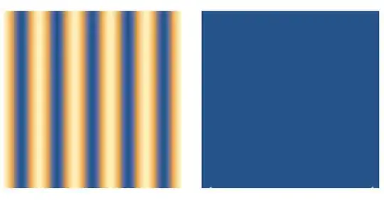

Here's what it looks like if we plot $\cos(y)$ instead:

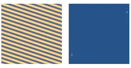

Okay, cool. Now, generally in 2D, a wave could propagate in any direction within the $x$-$y$ plane, with any frequency: $\cos(k \cdot r)=\cos(k_x x+k_y y)$. So here is $\cos(x+y)$:

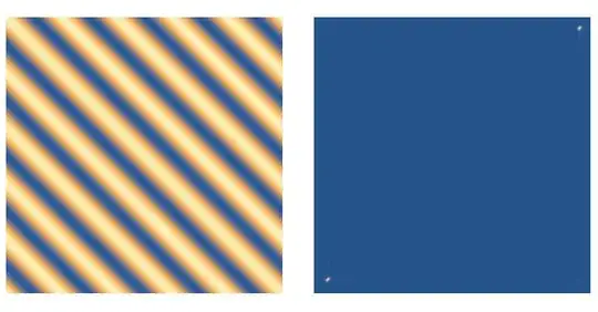

And here's $\cos(x+3y)$:

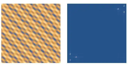

Of course, in the end, a complete image will be comprised of a linear combination of waves with all the wavevectors. Any image can be broken down this way. Here's $\cos(x+y)+\cos(x+3y)+\cos(3x+2y)$:
So what do I mean by "frequency" in all of this? I mean the number of periods which fit within the range of the image in a particular direction. In your first plots, the 1D example, the axis is understood to be representative of time. Therefore, the frequencies of the transform are temporal frequencies. However, if the axis were in units of length, the transform would show spatial frequencies. Since images are often in units of length, then the 2D transform is often interpreted as the spatial frequency spectrum which comprises the image.
