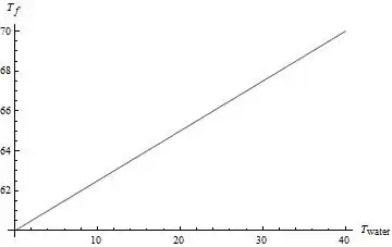

As a response to the comments, if you add hotter and hotter water to your coffee the final temperature after mixing will be higher (it will grow linearly with the temperature of the water you add.) Here is a plot for it.
