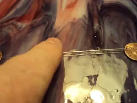

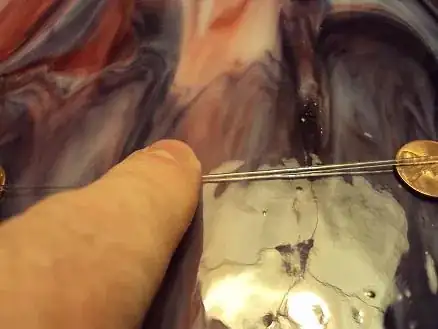

Having spent a great deal of time working with "normal" glass (one of my many hobbies), I can assure you that, in fact, all glasses can be bent. When cutting large sheets of glass, I always see the sheet bend before it breaks. Every now and then you have to strike it twice; the first time you bend it, it fails to break. Fiber optics differ from the usual glass partly in that it is very thin and so bends much more easily. After you've cut a few thousand pieces of glass you come to recognize differences between different compositions. Some glasses feel very smooth when they bend, others, like the stained art glass shown below, are rather ragged and difficult to bend. (And all breaks or cuts in glass begin with a bend.)
To get a more familiar metaphor, think about wood. It doesn't surprise you when a slat of wood that is 1mm in thickness is bent in a circle. Now imagine doing the same thing with a much thicker piece of wood. You can't do it with the thicker wood because it's too thick.
In addition, regular glass differs from fiber optic glass in that fiber optic glass is very pure and this makes it very strong. In the art glass community, thin glass rods is called "stringer". Let me see if I can find some photos of cold stringer being bent.
Okay, I found some clear stringer. I put it on a sheet of stained glass supported by two pennies. I took two photos, before and after pressing the stringer in the middle. You can see the bending. Straight:
Bent:
