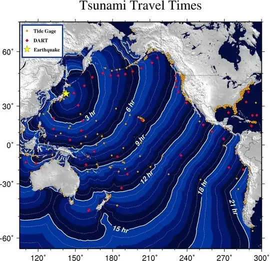

Well, immediately after the earthquake, they created the map showing when the tsunami arrives at different places:
I guess that it ended up being pretty accurate but I haven't checked. The speed of ocean waves actually depends on the frequency...

The problem of determining how much tsunami energy is going to be generated from a given earthquake isn't an easy one. Detailed knowledge of the seafloor motion would be needed. In principle this can probably be recovered from the seismic measurements, but you would need these results in real time. Also sometimes you set off an underwater landslide, i.e. a moderate earthquake can sometimes generate a tsunami because of other nonseismic factors. So the current paradigm is, precautionary evac near the source, then ocean bouy measurements can be used to estimate the magnitide/timing on distant shores. The local effects which can either focus or defocus energy as it interacts with the shoreline aren't easy to understand, so significant safety factors must be used to generate warnings.
