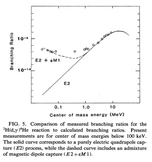

The likelihood of this reaction actually occurring is discussed in
Wilkinson & Cecil, "2H(d,$\gamma$)4He reaction at low energies." Phys. Rev. C31, 2036 (1985)
and references therein. Figure 5 of that article shows branching ratios for the $D + D \to {}^4\mathrm{He} + \gamma$ reaction of between $10^{-4}$ to $10^{-7}$, depending on the energy. (These branching ratios are calculated relative to the $D + D \to {}^3 \mathrm{H} + p$ reaction.) In other words, this reaction is somewhere between ten thousand and ten million times less frequent than the reaction in which a proton is released.
