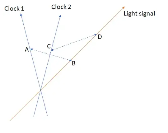

I suggest that you look at Einstein's paper On the Electrodynamics of Moving Bodies. Part I of the paper is quite accessible. It is the key to much of 20th century physics, because it introduced the idea that you need to measure something before you can really talk about it. If you want to measure velocity, you need to measure distances and times. If you set out from somewhere, say a specific door of the Empire State Building, we define that place to have coordinates (0,0,0), and the time that you set out is T=0. Easy. Now when you get to somewhere else, we measure the time at that place, but what does that actually mean? Einstein developed an ingenious method for synchronizing clocks at different places using light signals: On the Electrodynamics of Moving Bodies is about the consequences of following this method. NB: Einstein doesn't attempt to answer your question, though; he makes the constancy of the velocity of light into a postulate; we don't ask why all right angles are equal in Euclidean geometry, and we don't ask why the velocity of light is constant. How do we know that special relativity is a correct description of the world? It is the simplest theory that is consistent with experiment. Fast forward 20 years, and Heisenberg invented quantum mechanics by analogy with Einstein's 1905 paper: if you can't measure it (even in principle), you have no business talking about it.
I will present a diagram (called a spacetime diagram) and explain what it shows. You will have to trust that I have constructed the diagram correctly. My aim is to show how it can be that two observers in motion relative to one another along a line can nevertheless find that something else (here a light pulse) moving along that same line can have the same speed as observed by both of them.
The diagram shows a region of spacetime with two clocks and a light pulse. Clock 2 is moving to the right relative to clock 1. Clock 1 is moving to the left relative to clock 2. The light signal is moving to the right relative to both clocks. At event A clock 1 registers 1 second since the light went past both clocks. At event C clock 2 registers 1 second since the light went past both clocks.
Event B is simultaneous with A according to an observer travelling with clock 1.
Event D is simultaneous with C according to an observer travelling with clock 2.
The main thing to note is that the lines AB and CD have the same length. This means that the two observers agree about the distance travelled by the light signal during 1 second.
That's it! That's how two observers in relative motion can find that a light signal has the same speed for both of them. The reason it is surprising to our intuition is that we are not used to simultaneity being different for observers in different states of motion. Newtonian physics would say that the lines AB and CD ought to be both horizontal on the diagram, and then they would have different lengths. That Newtonian way of constructing a notion of simultaneity does not match with what is observed however.
Note that for this result it is not necessary to mention either time dilation or Lorentz contraction. It is only necessary to understand how simultaneity is modified.
In constructing the above diagram I have used a symmetric set-up, where the two clocks have equal and opposite velocities relative to any observer whose worldline is vertical on the diagram. This symmetry is why one can claim that equal distances up the two clock worldlines must represent equal amounts of elapsed time for each. This is an example of the principle of relativity. Owing to this same symmetry the distance scales along the two lines of simultaneity in the diagram must agree. A question in the comments asks how distance is measured along these lines. Since they both have the same scale you can simply use a ruler. The line AB answers the question "how far away is the photon after 1 second, for observer with clock 1?" The line CD answers the question "how far away is the photon after 1 second, for observer with clock 2?"
