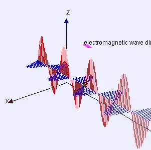

this is an animation of polarized light:
electromag
Electromagnetic waves can be imagined as a self-propagating transverse oscillating wave of electric and magnetic fields. This 3D animation shows a plane linearly polarized wave propagating from left to right. The electric and magnetic fields in such a wave are in-phase with each other, reaching minima and maxima together
In order to have a situation where two such waves would cancel and produce your "black":
  1. the waves should have the exact frequency and be at the exact opposite direction. This experiment can only be done with monochromatic sources, as are lasers,it has been done and can be viewed here. . The energy of the wave goes back to the source of the wave.
  2. White light depends on our perception of color and is composed by a large number of frequencies , see color perception here.
  3. To get a situation as in the experiment linked in 1) two white beams against each other are needed. The fact that white light is composed by innumerable frequencies means that the probability of overlap of two same frequency and polarization parts of the white beams is very small, so blackness (total extinction of white light) cannot result.
