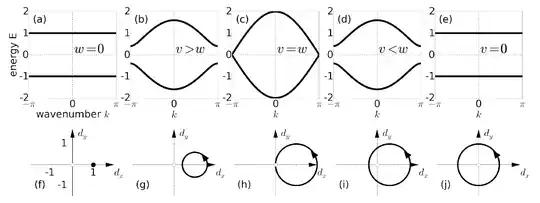

In the book A Short Course on Topological Insulators (https://arxiv.org/abs/1509.02295) the authors start with a simple toy model, the SSH-Chain, which is a bipartite one-dimensional lattice with alternating hopping amplitudes $v$ and $w$. Its second quantized Hamiltonian is \begin{equation} \hat{H} = \sum_j v (b_j^\dagger a_j + a_j^\dagger b_j) + w (a_{j+1}^\dagger b_j + b_j^\dagger a_{j+1}), \end{equation} where $a_j$ resp. $b_j$ annihilate a particle at site $j$ of sublattice A resp. B. In momentum representation we may write this Hamiltonian as \begin{equation} \hat{H} = \sum_k \begin{pmatrix} a_k^\dagger & b_k^\dagger \end{pmatrix} \underbrace{\begin{pmatrix} 0 & v + w e^{ik} \\ v + w e^{-ik} & 0 \end{pmatrix}}_{=H(k)} \begin{pmatrix} a_k \\ b_k \end{pmatrix}. \end{equation} The Bloch Hamiltonian $H(k) = d(k)\cdot \sigma$, as a 2x2 matrix, is a linear combination of Pauli matrices $\sigma = (\sigma_x, \sigma_y, \sigma_z)$. This leads to the definition of the $d$-vector. In this case \begin{equation} d(k) = \begin{pmatrix} v + w \cos k & w \sin k & 0 \end{pmatrix}. \end{equation} The authors of the above mentioned book continue by defining a topological invariant, which is the winding number $W$ of the $d$-vector around the origin and show numerically that for $W \neq 0$ the open chain has localized edge states, i.e. is in a topological phase. In the figure below we can see the band structure (the eigenvalues of $H(k)$) and the curve traced by the $d$-vector for different parameters v and w.
My questions:
  1. The figure shows that the trivial insulator has exactly the same band structure as the topological insulator (when switching v and w). In popular science you often read that the topology is a property of the energy bands. In this case it is obviously not true. Is it true in any case? Or is the topological nontriviality always found in the eigenstates of $H(k)$?
  2. It seems like topological invariants are always defined in terms of the Bloch Hamiltonian $H(k)$, which is obtained from the Hamiltonian in position representation by Fourier transform. This is also the case for the Quantum Hall Effect and Quantum Spin Hall Effect. But going to the momentum representation is only a change in the basis. So we should be able to see that a system is topologically nontrivial also in the position representation. Is this actually possible?

I suspect part of the issue lies in your assumption that "band structure" refers to the curves on the $(E,k)$ diagrams, which isn't true. Rather, the band structure refers broadly to the map $k \mapsto H(k)$ where we recall that for a system with translational symmetry we can write $$H = \int_{\mathrm{BZ}} H(k) |k \rangle\langle k|$$ via Fourier transform. For the SSH model, one may use the semi-discrete Fourier transform to obtain $$H(k) = \pmatrix{0 & v+we^{-ik}\\v+we^{ik} & 0}$$ where $k\in \mathrm{S}^1$, and so in the two extreme limits we have $$w=0,v=1\implies H(k) = \pmatrix{0 & 1\\1&0} \qquad u_+(k) = \frac{1}{\sqrt{2}}\pmatrix{1\\1} \qquad u_-(k) = \frac{1}{\sqrt{2}}\pmatrix{1\\-1}$$ $$w=1,v=0\implies H(k) = \pmatrix{0 & e^{-ik}\\e^{ik}&0} \qquad u_+(k) = \frac{1}{\sqrt{2}}\pmatrix{e^{ik}\\1} \qquad u_-(k) = \frac{1}{\sqrt{2}}\pmatrix{e^{ik}\\-1}$$
The eigenvalues $E(k)$ in both of these limits are $\pm 1$ for every value of $k$; this is what is plotted on the $(E,k)$ diagrams. However, the critical difference between them is related to how the phase "wraps around" as $k$ varies from $-\pi$ to $\pi$.
In order for the $u$'s to be continuous functions$^\dagger$ of $k\in \mathrm S^1$, they must be periodic functions of $k$ on the interval $[-\pi,\pi]$. In general, the Bloch functions in this model can be expressed as $$u_{\pm} = \frac{1}{\sqrt{2}} \pmatrix{e^{i\varphi(k)}\\\pm 1}$$ In order for this to be periodic, then we must have that $e^{i\varphi(\pi)}=e^{i\varphi(-\pi)} \implies e^{i\big(\varphi(\pi)-\varphi(-\pi)\big)}=1 \implies \varphi(\pi)-\varphi(-\pi)=2\pi \nu$ for some integer $\nu$. For the $(w,v)=(0,1)$ case, this occurs because $\varphi(k)=0$ is trivially periodic. For the $(w,v)=(1,0)$ case, $\varphi(k)=k$ is no longer periodic but $\varphi(\pi)-\varphi(-\pi)=2\pi$.
This integer $\nu$ can be extracted as follows:
$$\nu = \frac{\varphi(\pi)-\varphi(-\pi)}{2\pi} = \frac{1}{2\pi}\int_{-\pi}^\pi \varphi'(k) \mathrm dk = \frac{1}{\pi} \int_{-\pi}^\pi \langle u|(-i\partial_k) |u\rangle \mathrm dk$$
The integrand is the so-called Berry connection.
$^\dagger$As an important note, it is generally not possible to find continuous Bloch functions of this kind. It turns out that the Chern number corresponding to a given band is an indicator of whether we can do this. For a 1D Brillouin zone, however, the Berry curvature (and by extension the Chern number) is trivially zero, and we can always find a continuous Bloch function.
Popular science can't touch the ideas of eigenvalues and phase factors, for the most part. The band structure is the map $k\mapsto H(k)$, and it is this map and its associated ones (the Bloch functions, etc) which possess topological properties which may be trivial or non-trivial. The eigenvalues themselves do not inherently possess these properties.

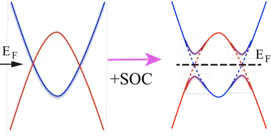

That being said, there are many situations in which the eigenvalues might suggest underlying topological nontriviality; when e.g. spin-orbit coupling causes band inversion, you get something like this (source):
The bulk (solid) curves on the right exhibit a tell-tale sign of band inversion, which is in this case accompanied by non-trivial topology which is manifested in the surface (dashed) energy curves.
