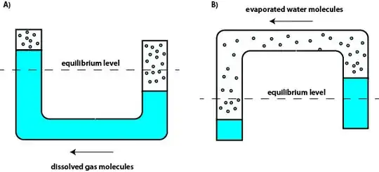

  1. The original question implied that gas exchange between the bubble and surrounding water may be enough to sustain indefinitely breathing organisms inside. However this does not seem to be possible if the bubble is below the sea level because the gas in the bubble will eventually dissolve in the water and the bubble will cease to exist. The reason is that the concentration of dissolved gas near the bubble surface has to be higher than the ambient concentration. The ambient concentration is not higher than its value at the ocean surface (it is convective mixing rather than diffusion what transports dissolved air into the ocean). However the bubble is at the pressure $\sim$4 times the atmospheric pressure, and according to the Henry law the dissolved gas concentration next to the bubble should be $\sim$4 times higher than the ambient (the possible variation of temperature does not change the overall conclusion). So eventually the dissolved gas will diffuse away and the bubble will disappear. Thus, for any size of the bubble, with or without breathing organisms inside, there is no steady-state solution, if the bubble is below the sea level. This is illustrated in the figure: for either regular or upside-down siphon, the equilibrium state has water level equal in both legs. If one leg end in Fig. A is below the equilibrium level then eventually there will be no gas on this side of the siphon; this is similar to having no water in one leg in Fig. B if the end of this leg is above the equilibrium level.
  2. The good news is that it would take a long time for the bubble to diffuse away. Estimate the diffusion time as
    $ \tau \sim \frac{n_{g}}{c} \frac{a^2}{D}, $
    where $c/n_g$ is the ratio of concentrations of dissolved gas molecules and gas molecules in the bubble, $a$ is the size of the bubble, $D$ is the diffusion coefficient of dissolved gas.
    According to Wikipedia, at 25 C, $c/n_g$ values are: for N$_2$ $1.492\times10^{-2}$; for O$_2$ $3.181\times10^{-2}$; for CO$_2$ $0.8317$.
    Also, according to Wikipedia, the values of $D_g$ are: for C0$_2$ at 5-25 C $1.07-1.91 \times 10^{-5}$ cm$^2$/s; for N$_2$ at 25 C $1.88 \times 10^{-5}$ cm$^2$/s; for O$_2$ at 25 C $2.1\times 10^{-5}$ cm$^2$/s.
    So, with these numbers, for an air bubble of the size $a\sim$ 1 m the lifetime is $\sim 10^{11}$ s $\sim$10,000 years! This is just unrealistic (if such things were possible we would've known about that!). The problem with this estimate is that the gas diffusion coefficient in water, D$_g\sim$10$^{-5}$cm$^2$/s = 10$^{-9}$m$^2$/s applies only to phenomena on small spatial scales, e.g., transport in porous media. We know that we can make carbonated water at home in a matter of minutes rather than months! On macroscopic scales transport is dominated by turbulence and convective flows, and, rather than diffusion, macroscopic transport models use the notion of effective ``exchange velocity'' $V_{ex}$, such that the flux of dissolved gas is
