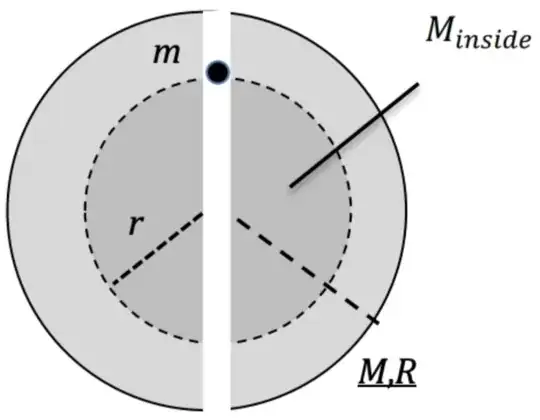

Our physics teacher was teaching us about gravitation. He said that the force of gravity in a uniform solid sphere is due to the mass of the smaller sphere inside
(On whose surface it sits)
And that the effect of
Force due to the ring/shell outside is zero
And thus the formulas
$$gd = 4/3 × πρ × (R – d) G.$$
When we asked him why the force due to ring was zero,
He replied
It was because the shell exerts equal force on the object in each direction which get cancelled
I am a bit unconvinced by this explanation
For the ring/shell to exert equal force in all directions on the object [that would cancel each other], the object should be placed at the center of the shell which is also the center of the sphere
However the object is only at a depth, d less than the sphere's radius.
This implies inequal force from all directions that do not cancel each other rrsulting in different values
Where am I wrong?

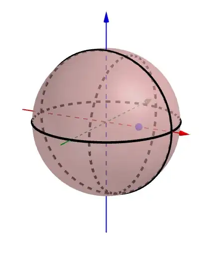

Well, the easy answer is that if you mathematically work it out and do the integral, it's zero. The derivation is something readily available online and you can look it up. Instead, I'll focus on an intuitive explanation.

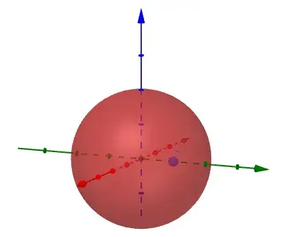

I'll remind you that you accurately stated that for all the forces to cancel themselves out, the object must be symmetrically located within the shell. That, in fact, is the case. Consider such a shell:

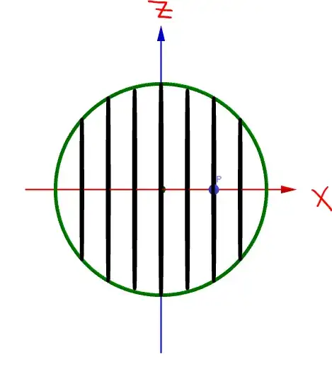

The green axis is the $x$-axis, and the point $A$ is our point mass that lies within the shell on the $x$-axis.
Let's take a circular slice of our shell as follows:

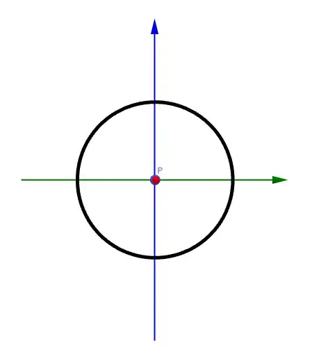

We can view this slice from the $xz$-plane as such (I simply rotated my axes such that the red $y$-axis is now sticking out of the page):
Notice how the force cancels itself out, because the object is indeed at the geometric center of this circle.

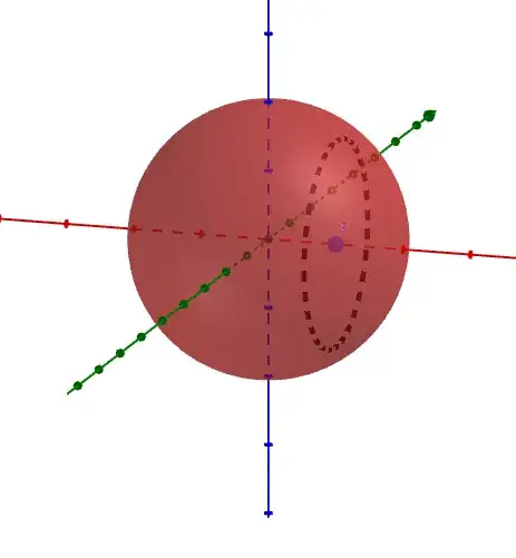

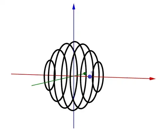

Now, we can rotate our view again, and chop up our shell the same way for all points on the $x$-axis. So, we make a bunch of circles that are centered around some point on the $x$-axis as shown:
Rotating our view again, we stare at it again from the $xz$ plane.

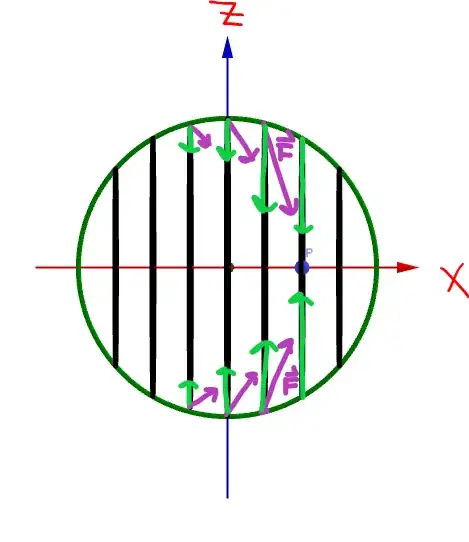

In the following image, I drew the force vector in purple generated by the mass due to each circle, and the green vector is the $z$-component of that force.
We realize that the $z$-component of the force of gravity is zero, since the $z$-components cancel themselves out.
So, by splitting our shell into a bunch of circles around the $x$-axis, we were able to show that the symmetry makes the net force in the $z$-direction zero.
We do the same for the $x$- and $y$-forces by splitting our shell into circles along the $z$- and $y$-axes as follows:
