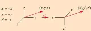

Parity involves a transformation that changes the algebraic sign of the coordinate system. Parity is an important idea in quantum mechanics because the wavefunctions which represent particles can behave in different ways upon transformation of the coordinate system which describes them. Under the parity transformation:
The parity transformation changes a right-handed coordinate system into a left-handed one or vice versa. Two applications of the parity transformation restores the coordinate system to its original state.
It is a reasonable presupposition that nature should not care whether its coordinate system is right-handed or left-handed, but surprisingly, that turns out not to be so. In a famous experiment by C. S. Wu, the non-conservation of parity in beta decay was demonstrated
