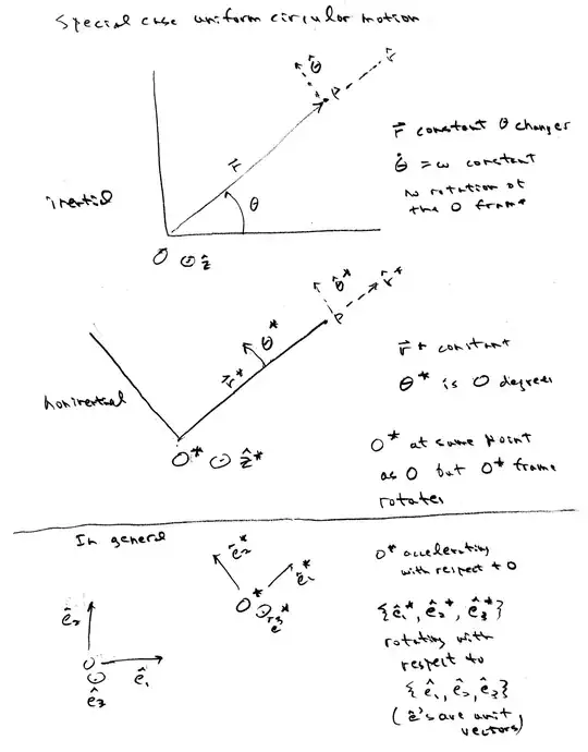

Consider two frames of reference, O and O*. O is the origin of a fixed point in an inertial frame. O* is the origin of a fixed point in a noninertial frame. In general O* can be accelerating with respect to O.
As a special case, let P be the position of a particle in O that moves in a circle with respect to O. Define O* such that the particle is at rest in O*; that is, O* is a non-inertial frame that rotates with respect to the O frame such that in O* the particle does not move. See the figure below.
In polar coordinates O has the unit vectors, $\hat {r}$, $\hat {\theta}$, and $\hat {z}$. In polar coordinates O* has the unit vectors $\hat {r^*}$, $\hat {\theta^*}$, and $\hat {z^*}$. $\hat {z}$ and $\hat {z^*}$ are the same (same direction). $\hat {\theta^*}$ is not the same as $\hat {\theta}$, and $\hat {r^*}$ is not the same as $\hat {r}$, since in O* we are rotating with the particle; specifically, $\hat {\theta^*}$ and $\hat {r^*}$ in O* are constant (do not change direction), but $\hat {\theta}$ and $\hat {r}$ and in O are not constant (change direction).
With respect to O, there is a force $\vec F_{applied}$ that causes circular motion, that being the centripetal force supplied, for example, by a string attached from O to the particle. $\vec F = m\vec a$ so $$ (1)\vec F_{applied} = -mr\omega^2\hat {r}$$ using the expression for acceleration in polar coordinates for this special case of uniform circular motion.
With respect to O* the particle is at rest so $\vec a^*$, the acceleration of the particle in the O* frame, is zero, $\vec F^* = m\vec a^*= 0$. Therefore, in addition to $\vec F_{applied}$, in O* there is a fictious force $\vec F_{cent}$, called the centrifugal force, such that $\vec F_{applied} + \vec F_{cent}= m\vec a^*= 0$. The centrifugal force here is $+mr\omega^2\hat {r}$. Therefore $$ (2)\vec F_{applied} + mr\omega^2\hat {r} = 0$$
Results (1) and (2) are the same, but are based on different frames of reference. (1) is using an inertial frame and there is a net external force causing acceleration in that frame. (2) is using a non-inertial frame where in that frame there is no acceleration; in this frame there is no net force so the applied force must be countered by the fictitious centrifugal force.
Both the inertial and non-inertial frames have a set of (typically) orthogonal unit vectors and in general all three unit vectors are different (have different directions) in the two frames. See the figure below. In general, O* can be accelerating with respect to O and the unit vectors in O* can be rotating with respect to O. In the general case, other fictitious forces appear in the non-inertial frame in addition to the centrifugal force, such as the Coriolis force.
The unit vectors in O* depend on how you define the motion of O*. For example, consider the point P in general motion in O. You can define O* as fixed at P and moving with P but with unit vectors in O* not rotating with respect to the unit vectors in O. If you have a rigid body whose center of mass is accelerating with respect to O and that is rotating with respect to O, you can define a set of body axes, fixed in O*, with O* at the center of mass, of the moving body, and evaluate the rotational motion about O* coupled with the translational motion of the CM at O*.
