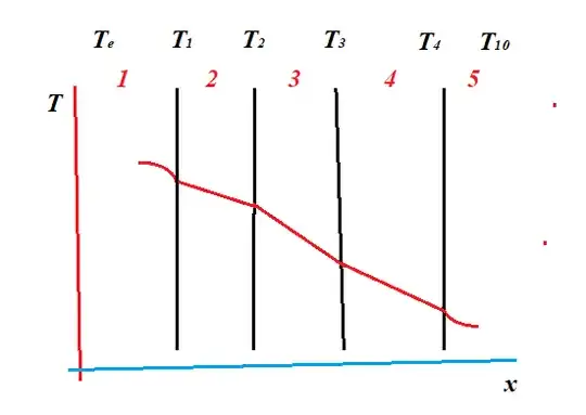

Consider the following composite wall:
composite wall
It has $3$ conduction zones, as well as $1$ inside convection zone and $1$ outside convection zone.
We assume steady state, so all temperatures are invariant to time. The red curve is the temperature profile throughout the wall.
It can then be shown that the heat flux $\dot{Q}$ flowing through the wall is given by:
$$\dot{Q}=UA\left(T_e-T_o\right)$$
($^{\dagger}$ see note)
where $U$ the overall heat transfer coefficient is given by:
$$\frac1U=\frac{1}{h_e}+\sum_i \frac{t_i}{\lambda_i}+\frac{1}{h_o}$$
Here, the $h$ are convection coefficients (see Newton's law of cooling), $t_i$ the thicknesses of the wall components and their respective heat conductivities $\lambda_i$.
Note that this doesn't take into account any thermal inertias but those don't feature in a steady state regime.
Without knowing $U$ no solution, transient or steady state, can be developed.
($^{\dagger}$ and not $T_{10}$ as written in the figure)
