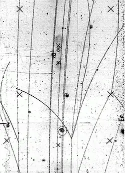

Elementary particle collisions have been made visible since the time of cloud chambers and bubble chambers. A good site for bubble chamber pictures exists . Unfortunately proton scattering is not as photogenic as scattering by other particles so I was unable to find a photo of a proton proton scatter in a bubble chamber though thousands must exist.
Here is one kaon from the beam hitting a proton in the bubble chamber and creating a number of new particles from its excess energy ( go to "would you like to see" for a list of particles).
Due to the kaon having interacted with a proton in the hydrogen, the rightmost beam track produces a spray of 4 tracks. The longer highlighted track is clearly dark – it has produced a higher number of bubbles per centimetre than, say, the beam tracks; this tells us that it is moving more slowly. (For details, click here.) Such tracks are a common feature in bubble chamber pictures and usually signify protons.
In the link there exists an explanation of how a bubble chamber works to make visible charged tracks coming from an interaction.
For LHC energies the detectors become more complicated and depend on electronics and computer outputs to get the same visibility. Vertex detectors and other track chambers give accurate images of the interactions, though the high multiplicity of vertices makes life more difficult.
