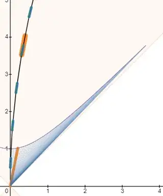

This visualization I made in Desmos might help:
https://www.desmos.com/calculator/tjngj63cat
robphy-desmos-acceleratedWorldline-1 enter image description here
Constant proper acceleration means that the change-in-rapidity $\Delta \theta$ ("Minkowski-angle") is proportional to proper time ["astronaut wristwatch time"] $\Delta\tau$ ("Minkowski arc-length"). (Proper-acceleration is akin to worldline-curvature, measuring the deviation from being a geodesic by the turning of the tangent-vector.)
The accelerated worldline is a hyperbola with timelike-tangents [time running upwards] and I have broken it up into sections suggesting the changes-in-rapidity for equal amounts of astronaut-proper-time. The astronaut's spatial-velocity according to the lab frame given by $c\tanh\theta$, essentially the astronaut's (orange) 4-velocity vector's slope with respect to the vertical [lab-frame worldline].
($v=c\tanh\theta$ is analogous to the Euclidean case where the slope is equal to the tangent of the angle of the tangent-vector: $m=\tan\phi$.)

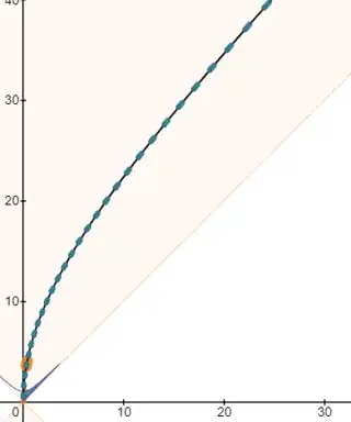

As $\theta$ increases without bound, $v_{astronaut}=c\tanh\theta$ asymptotically approaches $c$. You may have to zoom-out to see this behavior.
As the motion progresses (advance the $N_i$-slider in the visualization), subsequent equal-changes-in-rapidity correspond to decreasing-changes-in-spatial-velocity according to the lab frame.
These equal-changes-in-rapidity can be visualized as proportional to the equal-area hyperbolic sectors of the unit-hyperbola [with spacelike-tangents] cut by successive radii (representing the astronaut's 4-velocity in the lab frame).
