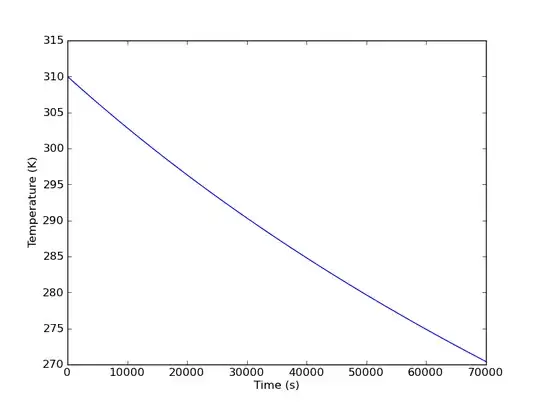

Here I have plotted the time evolution of the temperature according to this formula:
As you see, it takes approximately 65000 s (almost 18 hours) for the sphere to freeze. This is obviously something of a worst case scenario. I have not included the effect of heat produced by the human body, incoming (solar) radiation, less than perfect emissitivty, possible insulation, etc. These could make it take much longer or even prevent cooling, depending on the assumptions.

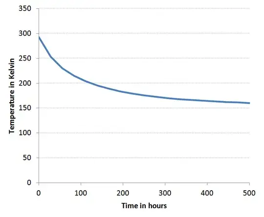

This has to be solved at every time step. Here's what I produced:
cooling with power production
The time frame is still about the same. Nothing really interesting to speak of. It should be noted that the astronaut's mass comes out to like $520 kg$, which is fairly unrealistic. That's a major factor in the time frames being as long as they are.
In the above graph the astronaut freezes in about 11 hours. While there is some correction needed for the radiative area exposed to space, the linear dimension of the astronaut exceeds a meter in the vertical, so there are corrections in both directions. While the effective radiative area should still probably be revised downward, it won't compare to the downward revision to the mass. So in practice you will freeze sooner. Maybe you'll freeze in 4 hours or so. You'll be comatose at 31 degrees C, which linearly interpolated, only takes about 13% of the time, or 39 minutes. Hypothermia should only take 12-13 minutes. Loss of hope, probably sooner.
