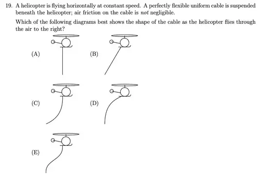

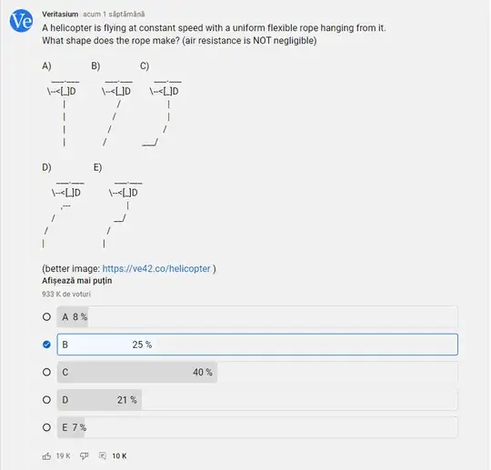

The above problem is taken from the 2014 $F=ma$ contest.
This question generated a great deal of controversy. At least two test takers challenged the answer, one who even tried to do the experiment. I’m told that several different “Ph.D” physicists declared that the correct answer was X, but, interestingly enough, couldn’t agree on what X should be.
In the YouTube poll the majority of people have chosen (C), however the correct answer is (B).
Veritasium took it to the next level, he rented a helicopter to reveal the real answer to the problem.

I think I got the solution. I chose (C) at the poll, but the correct answer is (B).

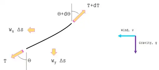

I think the answer you get depends on an assumption regarding aerodynamic forces. Split the rope into infinitesimal segments of length ${\rm d}s$ and follow along.
  1. Assume the aerodynamic force is proportional to the length of the segment $\Delta s$ regardless of the slope of the segment. This treats air flowing across the rope and along the rope the same and the rope & speed combination has a fixed aerodynamic weight value $w_y$ such that the force balance is
    fig1
    In the figure above $w_y$ is the weight per length of the rope, and $w_x$ the aerodynamic force per length which is horizontal and constant.
    In this scenario the force balance is
    $$ \begin{aligned} (T+{\rm d}T) \sin(\theta + {\rm d}\theta) - T \sin\theta & = w_x {\rm d}s \\ (T+{\rm d}T) \cos(\theta + {\rm d}\theta) - T \cos\theta & = w_y {\rm d}s \end{aligned}$$
    which is solved for the change in tension and change in angle using a small angle approximations ${\rm d}\theta \ll 1$, $\cos \theta \approx 1$ and $\sin \theta \approx \theta$. The solution is
    $$\begin{aligned} {\rm d}T & = (w_x \sin \theta + w_y \cos \theta) {\rm d}s \\ {\rm d}\theta & = \frac{w_x \cos \theta - w_y \sin \theta}{T} {\rm d}s \end{aligned}$$
    It reasonable to assume that $\tan \theta = \frac{w_x}{w_y}$ is a stable solution yielding ${\rm d}\theta =0 $ and ${\rm d}T = \sqrt{w_x^2+w_y^2}\; {\rm d}s$.
    From this point there no point to proceed since ${\rm d}\theta = 0$ means that the angle is constant, and the shape is straight line.

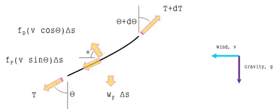

  1. But the more interesting scenario is that where the aerodynamic forces acting on the rope are not horizontal because there are different laws governing the air flow along the rope and the air flow across the rope. The flow along the rope I name "skin friction" and I assigned the function $f_{\rm F}(v_{\rm along})$ of force per unit length. The flow across the rope I name "pressure drag" and I assigned the function $f_{\rm D}(v_{\rm across})$ of force per unit length.
    fig2
    The decomposition of speed depends on the slope with $v_{\rm along} = v \sin \theta$ and $v_{\rm across} = v \cos \theta$.
    $$ \begin{aligned} (T+{\rm d}T) \sin(\theta + {\rm d}\theta) - T \sin\theta & = (f_{\rm D} \cos \theta + f_{\rm F} \sin \theta) {\rm d}s \\ (T+{\rm d}T) \cos(\theta + {\rm d}\theta) - T \cos\theta & = (w_y - f_{\rm D} \sin \theta + f_{\rm F} \cos \theta) {\rm d}s \end{aligned}$$
    which is solved for the change in tension and change in angle as follows
    $$\begin{aligned} {\rm d}T & = ( w_y \cos \theta + f_F ) {\rm d} s \\ {\rm d}\theta & = \frac{f_D - w_y \sin \theta}{T} {\rm d}s \end{aligned}$$
    Note that $f_{\rm D}$ and $f_{\rm F}$ depend on the angle via the speed component relationship. The above will give a straight line answer if $f_{\rm D}-w_y \sin \theta=0$.
    A little more detail here is that most likely $f_{\rm D} = \tfrac{1}{2} c_{\rm D} \rho D (v \cos \theta)^2 = h_{\rm D} \cos^2 \theta$. As such the stable angle solution is found by solving
    $$ h_{\rm D} \cos^2 \theta - w_y \sin\theta = 0$$
    the solution I got using the tan-half angle substitution is
    $$ \tan\left( \frac{\theta }{2} \right) = \frac{w_y}{2 h_{\rm D}} + \sqrt{ 1 + \left( \frac{w_y}{2 h_{\rm D}} \right)^2 } - \sqrt{ \frac{w_y}{h_{\rm D}} \left( \frac{w_y}{2 h_{\rm D}} + \sqrt{ 1 + \left( \frac{w_y}{2 h_{\rm D}} \right)^2 } \right) } $$
So I guess the summary is that in both scenarios it is possible to get a straight line shape, albeit at different angles.

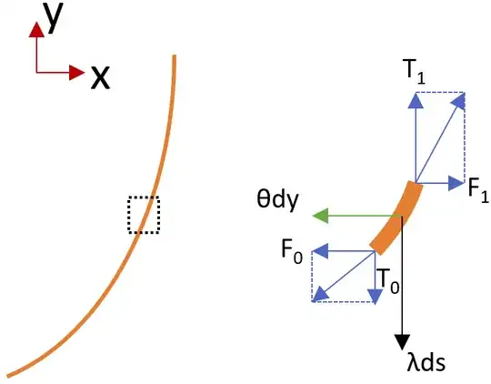

Here is my two cents
$\theta dy$ is the air drag on the small section, while $\lambda ds$ is the gravity on the small section.
$$y'|_{x} = \frac{T_0}{F_0}\tag1$$ $$y'|_{x+dx} = \frac{T_1}{F_1}\tag2$$ $$\theta dy + F_0 = F_1\tag3$$ $$\lambda ds + T_0 = T_1\tag4$$ Plug(1),(2) into (4) $$\lambda ds + F_0 y'|_{x}= F_1 y'|_{x+dx}\tag5$$ Plug(3) into (5) $$\lambda ds + (F_1-\theta dy)y'|_{x}= F_1 y'|_{x+dx}$$ $$\lambda ds- \theta y'|_{x} dy = F_1 (y'|_{x+dx} - y'|_{x}) $$ $$\lambda \frac{ds}{dx} - \theta y'|_{x} \frac{dy}{dx} = F_1 y''|_{x} $$ $$\lambda \sqrt{1+(y')^2} - \theta y'^2= F_1 y'' \tag6$$ One solution to this is $y'= const = \sqrt{\frac{(\frac{\lambda}{\theta})^2+\sqrt{(\frac{\lambda}{\theta})^2+4\frac{\lambda}{\theta}}}{2}}$, thus a straight line.

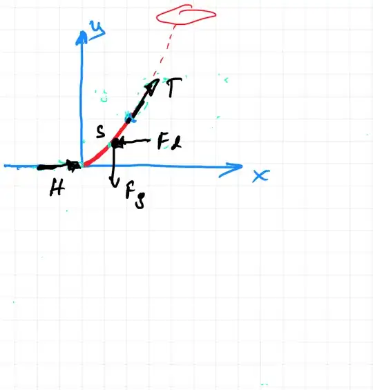

for a piece of the rope with the length $~s(x)~$
take the sum of the forces
$$\sum F_x=T\,\cos(\theta)-F_d+H=0$$ $$\sum F_y=T\,\sin(\theta)-F_g=0$$
the weight force $~F_g~$ is
$$F_g=m\,g=\rho\,A\,g\,s(x)=\rho\,A\,g\,\int_0^x\sqrt{1+y'^2}\,dx$$
the drag force is proportional to the rope length $~s(x)~$
$$F_d=\kappa\int_0^x\sqrt{1+y'^2}\,dx$$
the tension force H at the end of the rope is zero so
$$\frac{dy}{dx}=\frac{T\,\sin(\theta)}{T\,\cos(\theta)}=\tan(\theta)=\frac{F_g}{F_d}=\frac{\rho\,A\,g}{\kappa}=k\quad \Rightarrow\\ y(x)=k\,x+c$$
hence: the solution is B
Notice that if $~F_d=0~$ and $~H\ne 0~$ you obtain
$$y'=\frac{F_g}{H}=\frac{\rho\,A\,g\,\int_0^x\sqrt{1+y'^2}\,dx}{H}\\ y''=\frac{\rho\,A\,g}{H}\,\sqrt{1+y'^2}$$
this is the well known chain differential equation
