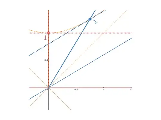

Write $$g_{ab}=\left( \begin{array}{cccc} 1 & 0 & 0 &0 \\ 0 & -E & 0 &0 \\ 0 & 0 & -E &0 \\ 0 & 0 & 0 &-E \end{array}\right)$$ and let $E$ vary from $-1$ (Euclidean space) to $+1$ (Minkowski spacetime), with $0$ as the degenerate time-metric of the Galilean spacetime.
Try my Desmos visualization:
robphy v8e spacetime diagrammer for relativity (v8e-2021) - t-UP https://www.desmos.com/calculator/emqe6uyzha
and play with the E-slider. robphy-Desmos-SpacetimeDiagrammer-Eslider

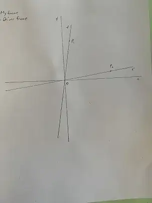

Another very important point is that time now has properties that you only think of space as having. This is best seen on a space time diagram.
I stand by the road as a car passes by.
  • As I move forward in time, my position is always $O$, or $x = 0$. At the instant the car passes me, its position is also $O$. I say whatever happens on the road at $P_1$ will happen someplace else.
  • The driver says his position the same for all times and the world is passing by. At the instant I pass him, his position is $O$, or $x' = 0$. I momentarily have the same position as he does, but I move on. He says whatever will happen at $P_1$ will happen right here.
  • It is OK for him to think of $O$ and $P_1$ happening in the same place, but for me in a different frame to think they happen in different places.
  • So long as a point can be reached from $O$ by traveling slower than c, it doesn't matter how far away it is. A frame of reference (car speed below c) can be arranged where it happens at the same place as $O$.
Time has all these properties too.
  • The entire road moves forward in time. At the instant the car passes me, the entire road is at $t = 0$. I say whatever happens on the road at $P_2$ will happen in the future.
  • The driver says the entire road moves forward in time. At the instant I pass him, the entire road is at $t' = 0$. I momentarily have the same time as he does, but I move on. He says whatever happens on the road at $P_2$ is happening right now.
  • It is OK for him to think of $O$ and $P_2$ happening at the same time, but for me in a different frame to think they happen at different times.
  • So long as you would have to travel faster than light to reach a point from $O$, it doesn't matter how far in the past or future it is. A frame of reference (car speed below c) can be arranged where it happens at the same time as $O$.
