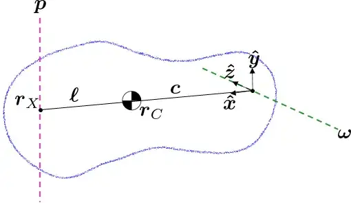

There is a beautiful relationship between the location of the center of mass and the location of the axis of percussion. Without loss of generality place the origin on the rotation axis, with z-axis along the rotation and x-axis towards the center of mass
fig1
If the body has a radius of gyration $R_{\rm gyr}$ for the rotation axis $\boldsymbol{\omega}$ about the center of mass then the distance to the percussion axis $\| \boldsymbol{\ell} \|$ is described by the following equation
$$ \| \boldsymbol{c} \| \| \boldsymbol{\ell} \| = R_{\rm gyr}^2 $$
Note that $\boldsymbol{\ell}$ is always on the opposite side of the center of mass. Also, there are two special cases
  • $\boldsymbol{c}=0$, body rotating about the center of mass, means that $\boldsymbol{\ell} = \infty$
  • $\boldsymbol{\ell} =0$, body purely translating, means that $\boldsymbol{c} = \infty$ or the rotation center is at infinity.
In the scenario above you have
$$\begin{aligned}\boldsymbol{r}_{C} & =\boldsymbol{\hat{x}}c\\ \boldsymbol{\omega} & =\boldsymbol{\hat{z}}\,\omega\\ \boldsymbol{\omega}\times\boldsymbol{r}_{C} & =\omega \,c\,\boldsymbol{\hat{y}} \end{aligned}$$
and
$$\begin{aligned}\boldsymbol{p} & =m\left(\boldsymbol{\omega}\times\boldsymbol{r}_{C}\right)=m\omega c\left(\boldsymbol{\hat{z}}\times\boldsymbol{\hat{x}}\right)=m\omega c\boldsymbol{\hat{y}}\\ \boldsymbol{L} & =\mathrm{I}_{C}\boldsymbol{\omega}+\boldsymbol{r}_{C}\times\boldsymbol{p}=\omega\left(\mathrm{I}_{C}\boldsymbol{\hat{z}}+mc^{2}\boldsymbol{\hat{z}}\right) \end{aligned}$$
Consider the case where $\boldsymbol{\hat{z}}$ is one of the principal axes of rotation, with radius of gyration $R_{\rm gyr}^2$, then from above
$$ \boldsymbol{L}=\omega\,m\left(R_{{\rm gyr}}^{2}+c^{2}\right)\boldsymbol{\hat{z}} $$
and if you use this into (3) you will get
$$ \boxed{ \boldsymbol{r}_{X} = \boldsymbol{r}_{C}+\frac{R_{{\rm gyr}}^{2}}{c}\boldsymbol{\hat{x}}} \tag{4} $$
The axis of percussion is beyond the center of mass by a distance of $R_{\rm gyr}^2/c$.
A point particle has zero radius of gyration, so the percussion axis passes through the center of mass. The higher the radius of gyration is the further away from the center of mass the percussion axis is.
Also given a radius of gyration, the closer the center of mass is to pivot point, the further away the percussion axis is, and the other way around. The mimimum distance the axis of percussion is from the pivot point is $2 R_{\rm gyr}$ which occurs when the center of mass is one radius of gyration away from the pivot $c = R_{\rm gyr}$.
