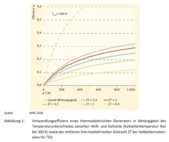

yes, it's the Carnot limit. Efficiency is given by
$\eta = \frac{T_h-T_l}{T_h} * \frac{\sqrt(1+ZT_m)\,-\, 1}{\sqrt(1+ZT_m)\,+\,T_l/T_h}$ with $Z= \frac{S^2 \sigma}{\kappa}$
S Seebeck coefficient
$\sigma$ electrical conductivity
$\kappa$ thermal conductivity

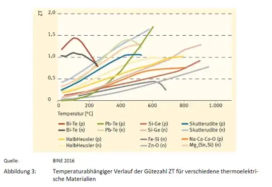

for Z called thermoelectric figure of merit there is no limit, although practically we have around 1 - 1,5
Reference for diagrams (sorry in German, but I am sure there a lot of other good papers in English):
