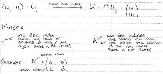

According to a small section of my notes, I have that:
Tensor notation and Kronecker delta
From the notes above, I think equation $(3)$ should be $$E^i{\,_j}=A{_{\color{red}{i}}}^{\,\color{blue}{k}}B^k{\,_j}\tag{4}$$ (where I have swapped the indices for the red and blue parts), since the transpose operation interchanges rows and columns and the section of notes shown above states that the lower index of the matrix labels the columns. So why is equation $(3)$ written that way when rows and columns are clearly being interchanged? By the way, I know that equation $(4)$ which I have written is actually wrong also, since the 'dummy index', $k$ is written up twice. But, what I am questioning here is what the transpose does to the indices.
From the image above, I have also been taught how to use the Kronecker delta metric (or identity matrix), which in the case of a $2\times 2$ identity matrix is $\delta^{ij}=\delta_{ij}=\begin{pmatrix}1 & 0 \\ 0 & 1 \\\end{pmatrix}$. So the way I see it, multiplying by the $\delta^{ij}$ essentially changes a row vector to a column vector, and my understanding of this is because the 'dummy index' ($j$ in the example in the top right of the image) is contracted upon so that the Kronecker is only non-zero when $i=j$ and this 'somehow' changes the original $U_i$ to $U^i$. Why this works the way it does is a question for another time, but for now, I would like to focus on trying to understand why the authors' solutions look the way they do for matrix multiplication.

You're right, equation (3) is wrong. When converting from implicit-index matrix notation to explicit-index notation, the contracted indices should always be the inner ones (the right index of the left factor and the left index of the right factor). As J. Murray said, it's the horizontal position of the index that determines whether it's a row or column index, not the vertical position.
Your equation (4) is correct except that it should be something like $δ_{k\ell}{A_i}^k{B^\ell}_j$, as I think you understand.
Your answers to questions 1 and 2 are also reasonable. They aren't wrong unless the question said that some of the matrices should have two lower indices.
The official answers are assuming, e.g., that $δ^{k\ell}B_{ik}={B_i}^\ell$. Strictly speaking, this is an abuse of notation. The two tensors named $B$ are different and should have different names. But it's common to abuse notation in this way, and when they do, you can safely assume that $δ$ raises or lowers an index without changing its horizontal position: that is, $δ^{k\ell}B_{ik} \ne {B^\ell}_i$. The order of the indices of $δ$ doesn't matter.
When evaluating $δ_{k\ell}{A_i}^k{B^\ell}_j$, you can either lower an index of $A$ to get $A_{i\ell}{B^\ell}_j$ or lower an index of $B$ to get ${A_i}^kB_{kj}$, and then sum over the repeated index. You can also just sum over both $k$ and $\ell$.
You can think of $U_i$ as a row vector and $U^i$ as a column vector, but beware that unless you consistently write matrices with ${{}^i}_j$ indices, products of these vectors with matrices won't always make sense. (Most obviously, you can't get a column vector from a row vector by multiplying it by $\begin{pmatrix}1&0\\0&1\end{pmatrix}$.)

In the absence of any further information, I would interpret "an $n\times n$ matrix" to mean "a $(1,1)$-tensor" whose first index is up and whose second index is down. Under that assumption, both of your answers are perfectly correct.
There exist objects with two downstairs (resp. upstairs) indices, and they are called $(0,2)$-tensors (resp. $(2,0)$-tensors). You can lay out their components in an $n\times n$ array just like a matrix, but their transformation properties are slightly different. For that reason, it's important to specify whether an object with two indices is a $(2,0)$-tensor, a $(1,1)$-tensor, or a $(0,2)$-tensor, but the language used in your question is conventionally understood to imply that $A,B,C,$ and $D$ are $(1,1)$-tensors.
[...] since the transpose operation interchanges rows and columns and the section of notes shown above states that the lower index of the matrix labels the columns.
Conventionally, it is the second (i.e right-most) index which labels the column, not the lower one. $A^i_{\ \ j}$ is the component of $A$ in the $i^{th}$ row and $j^{th}$ column; $B_{a}^{\ \ \ b}$ is the element of $B$ in the $a^{th}$ row and $b^{th}$ column.
