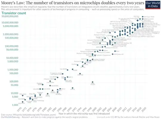

A typical computer might use $10^{10}$ MOSFETs in the CPU and GPU, and > $10^{11}$ in a large bank of RAM. A typical clock speed is > $10^9$ Hz. It might run hundreds of threads "in parallel" using $\approx 10$ processors. From Transistor count,
Max Roser, Hannah Ritchie, CC BY 4.0 https://creativecommons.org/licenses/by/4.0, via Wikimedia Commons
