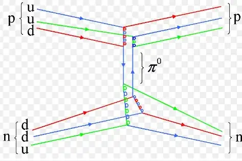

To try to explain fundamental quark interactions in terms of the pion exchange model used in nuclear physics is futile. See what the nuclear force is in feynman diagrams of the quark content of the nuclear interaction of a proton with a neutron in the nucleus in terms of quarks and gluons.
proton neutron interaction
The pion exchange model comes from a different simpler Quantum Field Theory, QFT for nuclei, example., which ignores the quarks and concentrates on protons , neutrons and various mesons for the exchanged particles in the Feynman diagrams.
