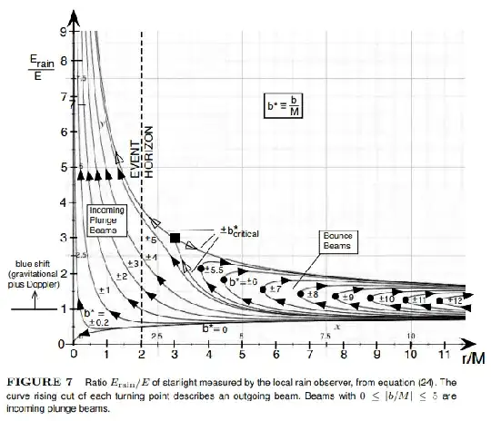

But remember that black holes can deflect light beams, so a light beam from behind can overtake you, be bent round 180° by the black hole and then move back towards you again. Now the light is moving towards you so it is blue shifted, and in principle this blue shift can become infinitely large. This is what Taylor et al are referring to in their figure 7 in chapter 12:
Blue shift
The value $b$ on the graph is the impact parameter. When $b = 0$ the light is coming from directly behind you and you and the light just fall in a straight line directly into the black hole. In this case you see the light redshifted all the way to your final doom at the singularity at the centre. Value of $b \ne 0$ means the light is not coming from directly behind you so it can be deflected by the black hole and meet you from a different direction. Whether you see this light as blue or red shifted depends on the direction in which it meets you.
