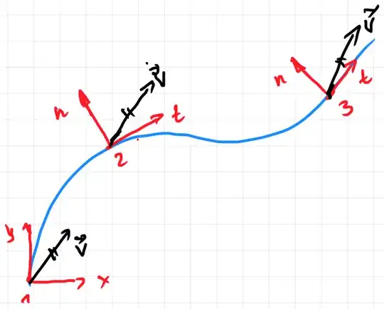

When vector are present in cartesian coordinates, the basis vectors look useless. After all, a vector (4,2) = 4(1,0) + 2(0,1) doesn't add new information.
In polar coordinates, each point has a set of basis vectors, and any vector acting in the point is a linear combination of them.
It is easy to understand for a point in the earth surface. It is defined by 2 coordinates: longitude and latitude. For each pair of that coordinates, we can set 2 vectors: One of them pointing North and other East for example. Now it is possible to define a velocity vector with a magnitude and a direction, based on these basis vectors for a neighborhood of that location.
you know the components ($~v_x~,v_y~$) of a vector at point 1
$$\vec v=\begin{bmatrix} v_x \\ v_y \\ \end{bmatrix}=v_x\,\underbrace{\begin{bmatrix} 1 \\ 0 \\ \end{bmatrix}}_{\vec e_x}+v_y\,\underbrace{\begin{bmatrix} 0 \\ 1 \\ \end{bmatrix}}_{\vec e_y}$$
where $~\vec e_x~,\vec e_y~$ are the basis vectors, they are linear independent with $~\vec e_x\cdot e_x=1~,~\vec e_y\cdot e_y=1~,\vec e_x\perp\vec e_y~$
note that the components are $$v_x=\vec v\,\cdot \vec e_x\\ v_y=\vec v\,\cdot \vec e_y$$
and the magnitude $~v=\sqrt{v_x^2+v_y^2}$
If you move the vector $~\vec v~$ to point 2 and you choose new basis vectors for convenience $~\vec e_t~,\vec e_n~$ hence
$$\vec v=\begin{bmatrix} v_x \\ v_y \\ \end{bmatrix}=v_t\,\vec e_t+v_n\,\vec e_n$$
the basis vectors fulfilled the requirement form $~\vec e_x~$ and $~\vec e_y~$ basis vectors.
the new components are
$$v_t=\vec v\,\cdot \vec e_t\\ v_n=\vec v\,\cdot \vec e_n$$
and the magnitude is unchanged $~v=\sqrt{v_x^2+v_y^2}$
at point 3 you obtain another components of the vector $\vec v~$ , again the magnitude is unchanged.
so nothing is wrong with this calculation ,choosing the basis vectors is only depending on what you want to achieve

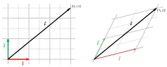

Part 1 - Addressing your confusion about basis vectors
I thought that basis vectors were of magnitude one
Consider what it means to express the same point two different bases.
Suppose you have the canonical (standard) basis $B = \{\hat I, \hat J\}$. Take some arbitrary pair of space-spanning (so, linearly independent) vectors $\vec i$ and $\vec j$ (not necessarily orthogonal, and not necessarily of unit length) and have them form a different basis $B' = \{\vec i, \vec j\}$.
Aside: Commonly (in a slight abuse of notation), you'd write an ordered basis as $B = \{e_1, e_2\}$, with the subscripts defining the ordering (so that you know which coordinate is associated with which basis vector). Since I'm using $I, J$ and $i, j$, there are no subscripts, but the usual ordering is assumed (dictionary ordering, $i \to j$).
Now, suppose you have some vector $\vec r$. Expressed in the standard basis, it's a linear combination of the basis vectors in $B$:
$$\vec{r} = x\hat I + y\hat J\space, \space\text{coordinates:}\space(x, y)$$
and in terms of the primed basis, the same vector can be expressed as a linear combination of $\vec i$ & $\vec j$, it's just that the coordinates will be different. So, in terms of $B'$, it's:
$$\vec{r} = u\vec i + v\vec j\space, \space\text{coordinates:}\space(u, v)$$
It's basically saying "take $u$ steps in the $\vec i$ direction, and take $v$ steps in the $\vec j$ direction". Note that this means that the $(u, v)$ coordinates of $\vec i$ and $\vec j$ in the primed basis are $(1, 0)$ and $(0, 1)$, respectively. So, expressed in their own basis, $\vec i$ & $\vec j$ are both of unit length, and orthogonal. Basically, working in terms of (u, v) coordinates is the same as working in the standard basis, it's just that there's this larger context, a coordinate-independent space of points, and the concrete point associated to each coordinate pair is different depending on which basis you choose.

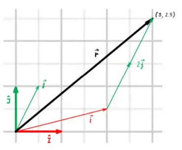

The neat thing is that this lets you convert between the two. Suppose that
$$\vec{i} = (2, 0.5)_B = 2\hat I + 0.5\hat J \\ \vec{j} = (0.5, 1)_B = 0.5\hat I + 1\hat J $$
(the subscript $(x, y)_B$ indicating the coordinate frame), and that you have $\vec r = (u, v)_{B\space '} = (1, 2)_{B\space '}$, and you want to know the corresponding $(x, y)_B$ representation. Well, just scale $\vec i$ & $\vec j$ by $u$ & $v$, respectively:
$$\vec{r} = 1\vec i + 2\vec j \\ = 1(2\hat I + 0.5\hat J) + 2(0.5\hat I + 1\hat J) \\ = 3\hat I + 2.5\hat J $$
So you get that the corresponding $(x, y)_B$ is $(3, 2.5)_B$.
In matrix form:
$$ \begin{bmatrix} 3 \\ 2.5 \\ \end{bmatrix} = \begin{bmatrix} 2 & 0.5 \\ 0.5 & 1 \\ \end{bmatrix} \begin{bmatrix} 1 \\ 2 \\ \end{bmatrix} $$

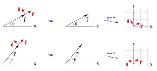

Part 2 - Addressing your confusion about local frames
I thought that basis vectors were [...] located at the origin [...], so how in things like polar coordinates can the basis vectors be moving?
Mathematically, vectors don't have distinct origin points - they are just a direction and a magnitude (geometric vectors, anyway). You can visualize this by thinking of all vectors as emanating from the origin of a Euclidean coordinate system; the endpoint then corresponds to the coordinate representation in the standard basis.
In other words, even things like velocities, accelerations, forces - all these by themselves don't have an intrinsic origin point. Each is, really, just a direction and a magnitude. This makes the math work out. But in physics, you often want to attach an extra bit of "metadata" to such vectors, to better describe the bigger picture (beyond just the "mathematical tooling" of linear algebra), so you often translate the vector in space so that it starts at some sensible-looking point on an object.
Or, think about force fields; to each point in space, a vector (force) is attached. The vectors are often represented as emanating from the associated point. But, another way to think about this is that you have a function that takes a point in space, and produces a vector. So, imagine some application that provides UI that lets you select a point as input, and that has a separate window to show the output vector emanating from the origin; as you move the input point around, the output vector changes magnitude and direction. You can get back to the usual picture by mentally translating the vector to the input point.
You can do the same thing with coordinate frames. A problem may be difficult to solve or express in the standard basis, and easier to deal with in some other (primed) basis. The new basis vectors do emanate from the origin, but the primed basis itself is often associated with some point in space - perhaps it's only useful at the immediate vicinity of that point (good enough for calculus!).
So you can think of it as of a local frame associated with that point.
As you change the "input" point, the associated basis changes - the basis vectors change direction and magnitude. In essence, you have a different local basis for each point in space. But because directions and magnitudes vary smoothly, you can think of the process as of a local basis "moving", "rotating" and more generally, "changing shape".
"Coordinates" is a more general term that "basis vectors". Basis vectors apply only to vector spaces, while coordinates apply to any manifold (and, if one uses the term loosely enough, pretty much any space). Basis vectors provide a coordinate system by simply taking their coefficients, but not all coordinate systems correspond to a set of basis vectors. Also, while basis vectors do have to be independent, they do not have to have magnitude $1$, and in fact vector spaces do not have to have any norm at all to have basis vectors, and if a space doesn't have a norm, then "magnitude $1$" is meaningless. Additionally, vectors aren't really "located" at the origin. The are often represented as displacements from the origin to another point in affine space, but that's not quite the same thing as being "at" the origin.
Polar coordinates are not based on basis vectors, although we can use them to define local basis vectors for each point.
