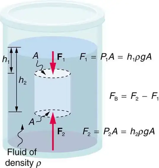

Look at the picture. The pressure in a fluid is same at same height and increases as go in depth. The pressure is equal to $p ×h×g$. To get the force on surface multiply this pressure with Area of surface. The force from sideways will cancel out. Now the important step to be taken here is calculating upward and downward force. There are two ways to find force. First one, Convert the shape into cuboid or cylindrical shape so that base and top becomes flat. Both areas would becomes equal. Second one, First find each perpendicular component of force to base and then find their component pependicular to ground.
Force at top $$F1 = A\rho h1g$$ Force at base $$F2= Aph2g $$ ($\rho $ remains same as fluid is incompressible)
Net force $$ F = A\rho hg(h2-h1) upward$$ = - Weight of fluid displaced
