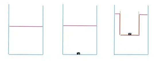

Let's exaggerate the situation so we can imagine it better. The cup has almost no mass, but the lead is extremely dense and heavy. The pot is only slightly bigger than the cup.
Here are three cases:
Left, just the water.
Middle, we put the small very dense lead mass in and the water rises slightly (displacing only it's own volume of water).
Right, the heavy lead is now in the cup. As you can imagine, the cup has to sink quite far until the weight of the displaced liquid matches the weight of the lead (Archimedes principle). So the liquid rises far relative to the first case.
The question about the lead block being removed from the cup and put in the water is like going from the right hand diagram to the middle one (just imagine the light empty cup floating on top of the water) - so the water level falls.
