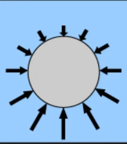

The fluid does not really exert an upward force on a body. It exerts a force everywhere on the body normal to its surface.
enter image description here [Adapted from Hyperphysics]
In a gravitational field, the pressure increases with depth, so those normal forces which would otherwise cancel, end up summing to an upward force vector. If the tank were placed on, say, a centrifuge, where the local acceleration pointed outward and caused a sideways pressure gradient, the object would likewise "float" sideways.

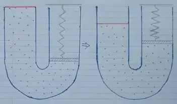

In the left diagram the piston is held with the spring at natural length. It's then released and settles down to the diagram on the right.
The spring is then under compression and shows that there is a upward force on the piston. This upward force is equal to the weight of a section of liquid with a height equal to the difference in levels between the piston and the red line on the right hand diagram.
So when an object is submerged in water, there is an upward force due to the pressure at the bottom of the object - it's $h\rho g$ where $h$ is the depth to the bottom of the object ($h_2$) and $\rho$ is density.
The pressure at the top is less, $h\rho g$ again but this time with a lower value of $h$, say $h_1$. The resultant upward force is $A\times (h_2 - h_1)\rho g$, where $A$ is the area.
For a cuboid object, since volume $V = A\times (h_2 - h_1)$ we can get to Archimedes principle $$F = \rho Vg$$ 'Upthrust is equal to the weight of the fluid displaced'.

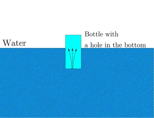

Consider a container filled with some fluid. If you were to drill a hole in the container(below the water level) than no matter wherever you drilled the hole(on either side or at the bottom) the fluid would flow out. BUT let's say the container was enclosed and you drilled a hole on top of a container. This time the fluid wouldn't flow out even if the container was absolutely filled with water.
Let me use the same line of reasoning to answer your question.

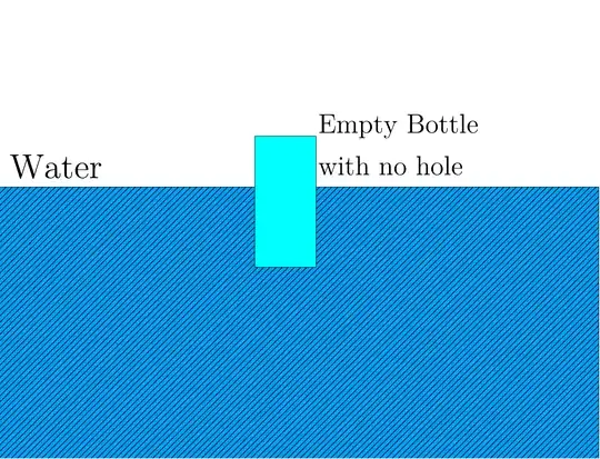

Take an empty bottle and punch a small hole in its bottom. Place it on the water surface. There will be no water shooting out of the hole.
Now press the bottle into the water. You will see that the water now shoots out of the hole. And, this is the origin of the upward push you feel while pressing the bottle into the water.
Note that even if the bottle is just floating on the water surface, it is pressing against the water ever so slightly due to gravity. This causes the water to exert a force (equal to the volume displaced by the bottle), and this is why the bottle floats.
