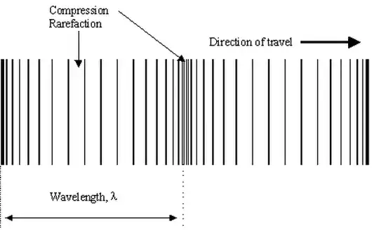

Now, imagine you have both source of force and an extremely rigid string. Now you are pulling or pushing the string, but the fact is the force doesn't show up at the end instantaneously. Force travels through the rope as a form of longitudinal wave like this, enter image description here
Because when you apply force on one end, it propagates through the collision of atoms, the atom at the back pushes the front one, and thus force propagates.
Note: When you take a small string and pull it, it seems like the force reaches the other end instantaneously, this happens because it is small and thus force reach the other end very fast, but for long rope, particularly this big ($3×10^8 \ \text{m}$), it is not instantaneous.
