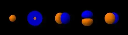

In particularly an electron caught in a potential well has its energy described by the solutions of the quantum mechanical equations. It is not in an orbit around the nucleus it is in an orbital and best understood as a probability wave:
orbitals
The shapes of the first five atomic orbitals: $1s, 2s, 2px, 2py$, and $2pz$. The colors show the wave function phase. These are graphs of $\psi(x, y, z)$ functions which depend on the coordinates of one electron.
The square of $\psi(x, y, z)$ gives the probability of finding the electron at that space point.
squared
The five d orbitals in $\psi(x, y, z)**2$ form, with a combination diagram showing how they fit together to fill space around an atomic nucleus.
These are orbitals with higher angular momentum l=2
So velocity of the electron has no meaning here . It is pure quantum mechanical probability distributions. The shell energy defines the amount of energy needed to kick the electron out of its orbital, with a photon or another interaction. The lower the n quantum number the tighter the binding. When free it can exhibit its particle nature and have a velocity assigned to it .

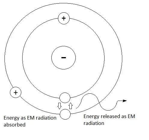

The electron(- charge) wants to be as close as possible to the proton(+ charge). Therefore, it takes more energy to have a larger shell, than a smaller one. In fact, when an electron shifts to a lower shell, it releases the energy that was pent-up keeping away from the proton, as light. Photon emission

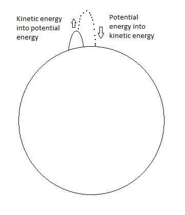

I like to think of it like a baseball on earth. If carry the baseball up a hill 10 meters above sea-level, if has more potential energy than a baseball that you are carrying at sea-level. If you drop the baseball of a cliff from 10m, it changes some of the potential energy into kinetic energy, and moves closer to sea-level.
Just like a baseball, a photon shifting shells converts potential energy into light, as it "falls" a distance toward the proton.
If someone were to catch your hypothetical baseball, and throw it back, it would gain potential energy as it traveled upwards. Likewise, if an atom absorbs energy in the form of heat, or light, the electrons in the cloud will gain potential energy, and move "upward" away from the atom.
