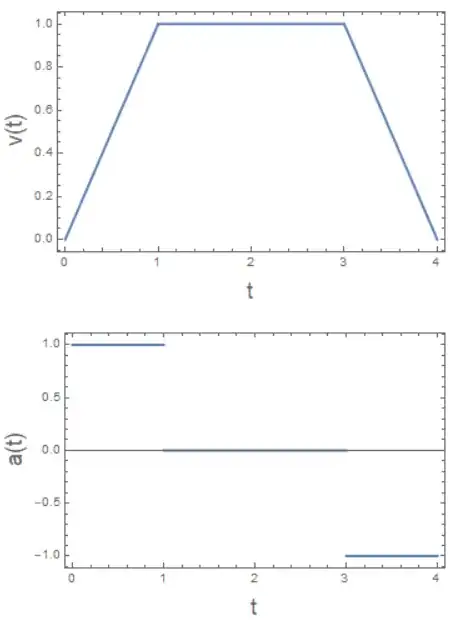

Here's a general way to look at it:
For starters assume you have all your weight on one leg, so the other leg is hovering very slightly above the ground. If we didn't assume this we would have to account for the weight shifting from one leg to the other and this would complicate the story ever so slightly. At this point you are still stationary so the force on your standing leg is exactly $mg$. During the lifting of your leg your center of mass moves a little bit upward. Unless rotations are involved you can treat objects like they are point masses located at their center of mass. So for example to calculate the work that was done you can calculate the height of the center of mass before you lift your leg and the height after and use the difference to calculate $\Delta W=mg\Delta h$. The energy expended will generally be a bit higher because your muscles lose energy due to friction.
To look at the force that is exerted on the ground let's look at the height of your center of mass and we will assume there is a period of constant acceleration, a period of constant velocity and a period of constant deceleration. The velocity and acceleration graphs will look something like this:
The acceleration graph is the result of the total force on your body, which is given by $$F_\text{total}=F_\text{leg}+F_\text{gravity}$$ If you ponder a bit about how the signs should be you can conclude that
  1. during the initial constant acceleration $F_\text{leg}>mg$,
  2. during the phase of constant velocity $F_\text{leg}=mg$,
  3. during the last phase of constant deceleration $F_\text{leg}<mg$.
The graph that I showed above is ofcourse not how a real world graph will look like but it should give you a vague idea of what is happening.
