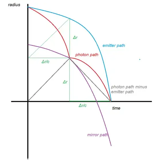

The mirror works more or less like you'd expect it to anywhere else. If the mirror and the emitter/observer are separated by a distance sufficient that there is a tidal difference in the gravitational field between them such that the acceleration due to gravity is different by $\Delta g$, then it looks like the observer is accelerating away from the mirror at $a=\Delta g$.
Below, a MSPaint graph of the path of the emitter / observer, the photon, and the mirror, for an emitter and mirror separated by a distance $\Delta r << r$, with the mirror directly below the emitter. The origin is an arbitrary point inside the event horizon below the emitter, $r_s>r>>0$.
The purple curve (mirror path) should be $\Delta r$ distance away from the blue curve (emitter path) at all time. It isn't, because my MSPaint skills are not that good.
Note how the grey path, which is what our observer/emitter sees, is the exact path we would expect for a light beam in no gravitational field, going out at c, bouncing off of a mirror, and coming right back to where it started at c.
If we had tidal effects (or if the emitter is on a rocket boosting away from the center while the mirror is in free fall), the second $\Delta r$ would be larger, so the photon would take longer to get back to the emitter. The observer/emitter measures a time dilation appropriate to a gravitational field of $\Delta g$, exactly as if they were accelerating away at $\Delta g$ far away from any gravitational fields.
Edit with correction for the graph: the grey path is emitter path minus photon path, not the other way around.
