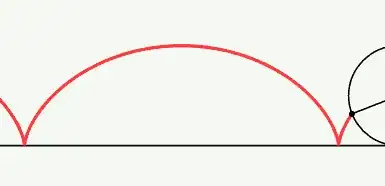

Instantaneously:
  • a particle in contact with the ground has velocity $0$
  • a particle on the opposite end of that diameter (at the top) will have a velocity $2v$.
The locus of any point on the cylinder is a cycloid.
From Rolling Circles
