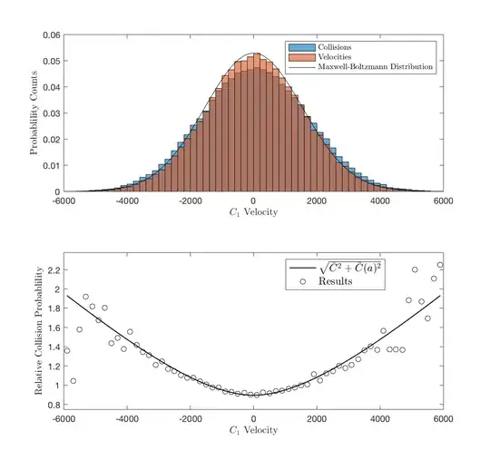

Using the basic model of the collision rate developed from kinetic theory suggests that the collision rate would be proportional to this mean speed value. However, from my data this seems to significantly overestimate the number of collisions. Results seem to agree better with a $\sqrt{\bar{C}_A^2+ \bar{C}_B^2}$ scaling. Does anyone have a 3D hard sphere particle simulation that could be used to shed any light on this?
