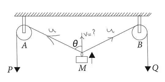

In the arrangement shown in the figure, the ends P and Q of an inextensible string move downwards with uniform speed u. Pulleys A and B are fixed. What is the speed with which mass m moves upward?
The textbook solution to this question says the mass m moves with u/cosθ. I have a big confusion here. If the string inclined on the left moves with 'u', similary the string on the right moves with 'u' as well, shouldn't the velocity with which the mass m moves upward be 2ucosθ? This is because the component of u along that unknown velocity of mass m will be ucosθ.
The book says: vcosθ = u ; hence, v = u/cosθ
I feel ucosθ = v
