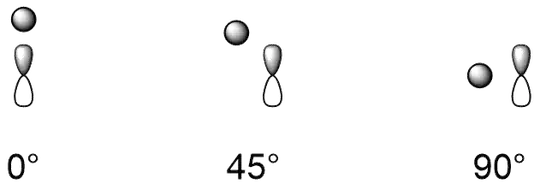

If we first take a look at only a single hydrogen atom, this could approach the oxygen atom and thus by extension one of the p orbitals in different ways as shown in the image below. (Due to symmetry, only an angle between 0° and 90° makes sense; phase designation is arbitrary.)
An s orbital approaching a p orbital at different angles
At 0°, the possible overlap between the two orbitals and thus the extent of constructive/destructive interference is greatest. That means, if we add the two orbitals together as outlined above, the resulting orbital will have the lowest possible total energy and it will be most favourable to the system. At 45°, the overlap is less good, but still okay. At 90° we have a problem: whatever we may gain from constructive overlap on one side of the p orbital's nodal plane (the top half in the picture) we will lose from destructive overlap on the other side. These two sides mathematically cancel each other out so that overall there is zero energy gained by this type of bonding.
