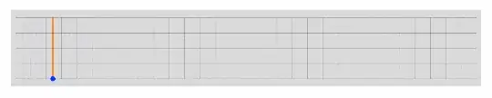

I made some animations for you.
The center of mass is the blue dot. When the cylinder is on a slippery floor, imagine it on an ice sheet, the point of contact (red) could just slide and no rotation on the cylinder occurs. Both dots travel at the same speed.

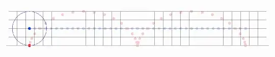

But if the cylinder is really rolling the initial point of contact is now orbiting the center of mass.
And it describes an interesting pattern.

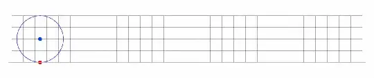

Let me now turn the camera to a top view, so you can clearly see the acceleration and deceleration pattern. I faded out the cylinder so you can focus on the initial line of contact.
You can clearly see that when the point of contact is again on the floor, the speed relative to the floor is zero.
Just to complement, here is a lateral view, so you also can see the vertical velocity.
In general, the speed of the red dot does depend on the speed of the center of mass, but on the specific moment the line is on contact to the floor, the speed is 0.
