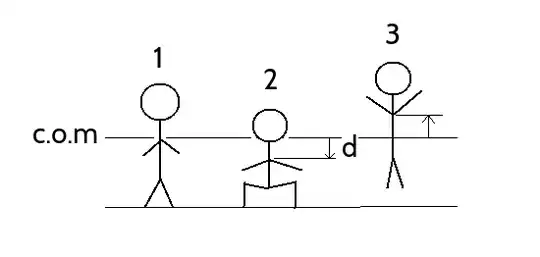

When you jump, you lower your center of mass by a distance $d$, and then your muscles contract and extend in various ways to push your center of mass up until you leave the ground. All the energy that gets expended in jumping gets converted to kinetic energy, $\frac{1}{2}mv^2$, and then that energy gets converted to potential energy, $mgh$. When you get to that height $h$, you are at the peak of your jump.

The work you do when you jump off the ground is given by $Fd$, where $F$ is the force you can apply and $d$ is the distance your center of mass covers with respect to your initial standing position. This will, assuming an ideal case, all be converted into kinetic energy which will all become potential energy when you reach the peak of your jump, at which your potential energy will be $mgh$, where $m$ is your mass, $g$ is the assumed constant acceleration downwards due to gravity, and $h$ is the maximum height you attain.
$$Fd=mgh \implies h=\frac{Fd}{mg}$$
If your volume is scaled down by a factor $k^3$ ($k$ in each direction of the canonical basis of $\mathbb{R}^3$, WLOG), then (assuming no change in mass-density) your mass will also scale down by $k^3$. By the assumptions made in the previous paragraphs, the force you apply to jump off the ground will scale down only by a factor $k^2$ (approximate scaling of the number of muscle fasicles), and obviously the distance that you displace your center of mass will scale by $k$. Thus,
$$h'=\frac{(k^2F)(kd)}{(k^3m)g}=\frac{Fd}{mg}=h$$
