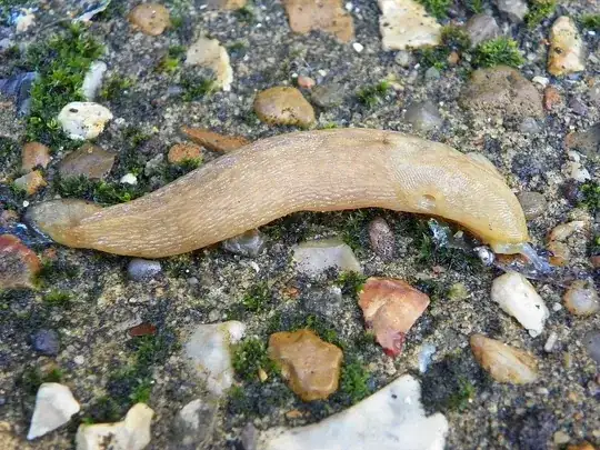

Yellow slug (Limax / Limacus flavus)
A yellow slug (Limacus flavus), a common species of mollusc. Photo by Wikimedia Commons user AnemoneProjectors, used under the CC-By-SA 2.0 license.
Even the bodies of many shelled molluscs (obviously excluding the shell itself) are notably flexible: for example, snails normally carry their shell on their back, keeping most of their body outside it, but they can pull their entire body inside the shell if threatened. Molluscs, whether shelled or not, also lack rigid limbs and instead commonly move around by undulating or otherwise deforming their flexible bodies.
Given the phrasing and context of your quote, I suspect that it's specifically this characteristic softness and non-rigidity of molluscs — and not their rigid shell — that Einstein was most likely alluding to when coining the term "reference mollusc" to describe a non-rigid reference body.

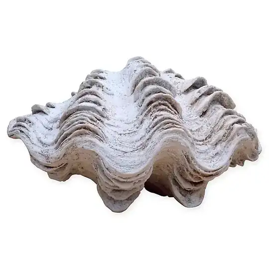

A mollusk is an animal like a clam, oyster, or snail, with a curved shell, or even an octopus without a shell. Einstein is using the word "mollusk" simply to convey the idea that the coordinates need not be flat Cartesian coordinates but can be curved almost arbitrarily like the shell or skin of a mollusk and even that they can deform over timeclam shell There is no deeper biological or other similar meaning, simply a familiar visual concept of an arbitrarily curved surface.
