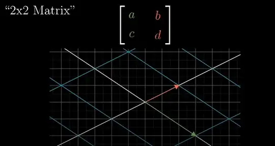

The second thing we need to review is how linear transformations change the geometry. As a general rule of thumb, linear transformations transform the basis vectors by squeezing/stretching them and changing their angles. I'm snipping a photo from 3blue1brown's GREAT video about linear transformations: enter image description here This image shows how lengths, angles and distances (geometry..) changes after a linear transformation. Mathematically, after a transformation $T$ the inner product between two vectors will be $$(Tu)\cdot (Tv) = (Tu)^t G (Tv) = u^t T^t G T v\neq u^t G v = u\cdot v$$ This means that the geometry of space will remain the same if and only if $T^t G T = G$. In the standard basis and geometry, where $G=I$, one can show that these are exactly rotations and mirroring! This is why rotating space doesn't change geometric quantities!
