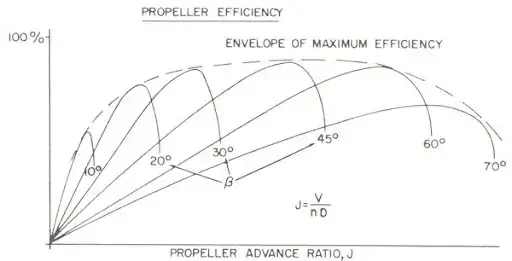

Like anything in fluid dynamics, there's no single analytic function to describe the behavior of a propellor.
In general, the thrust of the propellor works the same way as lift on an airplane wing. Lift goes as
$$ L = C_L \frac{\rho v^2 A}{2}$$
where $C_L$ is the empirically determined coefficient for that particular wing/propellor blade.
The "angle of bend" of the propellors is known as the "Angle of Attack". For any given speed through a fluid ("advance ratio", $J$), there's an optimal angle of attack (AoA, $\beta$).
Since you must conserve momentum and kinetic energy (ignoring frictional losses), a slow/large propellor is much more efficient than a fast/small propellor for a vehicle traveling at the same speed. Sending air molecules backward at speed $v$ gives you $\frac{v}{m}$ boost in momentum but costs $\frac{1}{2}mv^2$ energy (this concept is known as "propellor slip").
