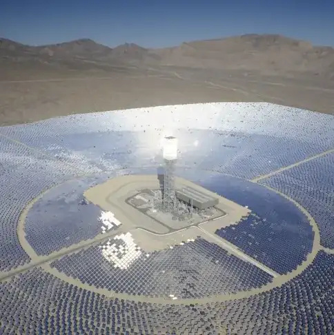

mirrors heating to white-hot
Power plant near Primm, NV where they point a couple hundred thousand huge, curved mirrors at a water tank and make it white hot:
https://en.m.wikipedia.org/wiki/Ivanpah_Solar_Power_Facility

It may seem like $330,000m^2$ of flat mirroring is implausible, until we see what’s been done (well over a million $m^2$ of curved, focused mirroring, see image).
