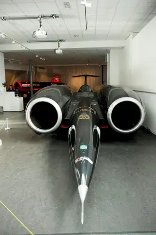

The claim is not quite true: many of the land speed records were established using cars with jet engines, as, e.g., ThrustSSC:
(image source)
There is however some dispute as to whether such a vehicle could be still called a "car/automobile", or whether the term should be reserved to the vehicles with internal combustion engines and the electric ones.

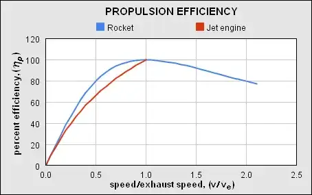

Taking the graph from the Propulsive efficiency article quoted in the Q.: enter image description here

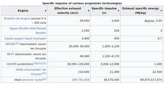

Typical exhaust velocities of the existing jet and rocket engines are given in the table below (see Specific impulse):
A typical car speed is $70$mph$\approx 110$km/h $\approx 30$m/s - this speed is simply too low to take advantage of the rocket technology.
Note further that the speed of sound is $340$m/s$\approx 1200$km/h$\approx 800$mph - the exhaust speeds, and the vehicle speeds, need to approach this value to have reasonable efficiency. This is true for the commercial airplanes, which move at about half of the speed of sound and higher, but not really an option for commercial road vehicles.
