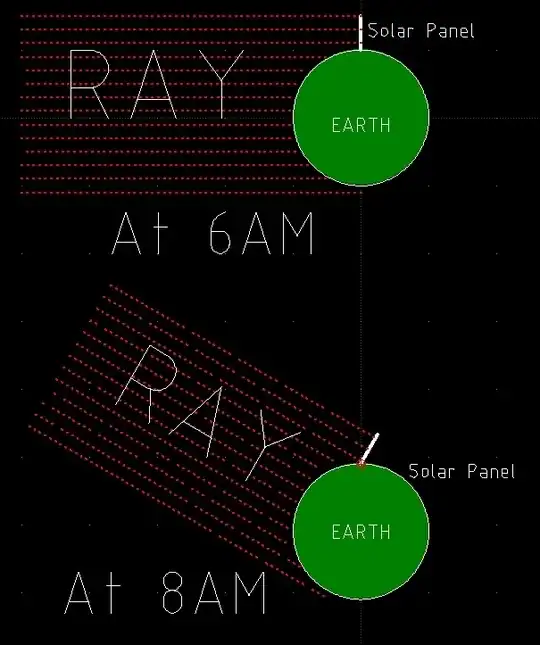

Consider I have a solar panel setup as in the above picture. The top sketch is sketching sun rays in the early morning around 6 AM in a clear bright sky. The bottom sketch is sketching the sun ray hitting the solar panel at around 8 AM.
I installed a solar panel on a mountain, where we usually see the sun more than 12 hours a day. I found that even if I turn the solar panel to face the early morning rays perpendicularly, it doesn't produce much electricity. But when it reaches around 8 AM with the solar panel to perpendicularly facing the sun, the electricity it produces will increase to almost maximum performance, not very different to the productivity at noon. Quantitatively, this is typically an increase in voltage from around 5V to 16V, of 18V maximum. In this case, it is the same sun, the same place, the same solar panel, and the same condition (it faces perpendicular to the sunray, as in the picture). So what is different in the early mornings here so that the output is so different?

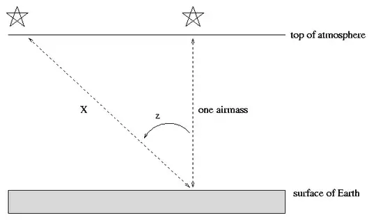

When the sun is near the horizon, the sun rays have to travel through more air to get to you than when it's directly overhead. This phenomenon is known as atmospheric extinction, and this page has a nice cartoon diagram to illustrate it:

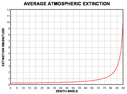

This effect can be quite large. This page has a graph of the approximate effect as a function of zenith angle, which is the angle from directly overhead; a zenith angle of 90° is therefore an object on the horizon.
This graph is logarithmic; every unit on the vertical axis corresponds to a factor of about 2.5 times less energy getting to the ground. We can see that anything closer than about 15° to the horizon will have its light diminished substantially, certainly enough that you would notice on a power meter.

If I understand your drawing, at all measurement times the sun is fully abvoe the horizon and the solar panel is always perpendicular to the line-of-sight to the sun.
In this case, what you are observing is the length of the path thru the atmosphere between "space" and the solar panel. The atmosphere absorbs a decent amount of light per km of travel (especially at lower altitudes), leading to the lower power/m^2 received at the panel. When the sun is close to overhead, this absorption path is much shorter.

It is the earth only you should be rotating, not the ray. The reason the amount of power produced in the morning is less than that of mid day, is due to the amount of light per unit area being less in the morning. This you should see by rotating the earth only, the number of ray lines hitting your detector will decrease.
If you're tracking the ray with your solar panel, then the amount of light hitting the panel within the range that it is sensitive to diminishes due to it having to travel through a longer path in the atmosphere.
