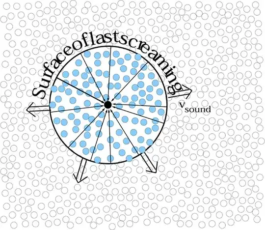

I struggled with visualising this for some time. What we are seeing as the CMB is the "surface of last scattering"; in other words the (receding) surface where photons were emitted after recombination.
I found Lineweaver's "surface of last screaming" a helpful analogy:
Surface of last screaming
Consider an infinite field full of people screaming. The circles are their heads. You are screaming too. (Your head is the black dot.) Now suppose everyone stops screaming at the same time. What will you hear? Sound travels at 330 m/s. One second after everyone stops screaming you will be able to hear the screams from a `surface of last screaming' 330 meters away from you in all directions. After 3 seconds the faint screaming will be coming from 1 km away...etc.
https://ned.ipac.caltech.edu/level5/March03/Lineweaver/Lineweaver7_2.html
