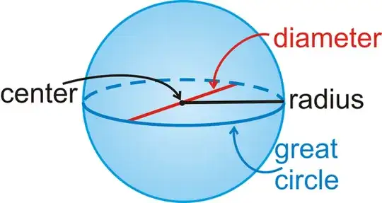

From what I understood, a Universe with a positive curvature should behave like a sphere, and light will eventually reach the point where it started. Similarly to a ball, when an ant starts to walk on a ball in a straight line, it will end up where it started.
However, if the Universe is a sphere, we are in the sphere, not on the sphere, right? And if I imagine myself being in the center of a sphere, and I start walking I see no reason I should return to the center.
If you cannot imagine it, this is what I mean. I am in the center, I start to walk on the red line, and what happens if I reach the end?
Enter image description here

The thing is, we are not inside a sphere. The 2-dimensional surface of a sphere is just an analogy of how a positively curved space works. It is also just a special case of positively curved space; it has curvature that is both homogeneous and isotropic.
Unfortunately, our brains are not conditioned to think of three dimensions as being curved, either positively or negatively. Instead of trying to draw a picture, the best we can do is to describe such a universe:
  1. A positively curved universe is closed, meaning it is finite in extent but has no edge.
  2. If you walk on a straight line, you will eventually end up where you started from.
  3. The angles of a triangle add up to more than 180 degrees.

When physicists and mathematicians say something is "a sphere", they mean a mathematical sphere. That could be a 3, 4, 5 or other dimensional sphere. So you have to ask "what is a sphere", outside normal language.
A sphere is defined as all the points in a space, that are the same distance from some fixed point. So in 3D its like the surface of a ball. In 2D we call it a circle (the "surface", or points equal distance from the centre, of a disc). In 4D and higher dimensions, we usually call it the surface af a hypersphere or N-sphere .
So when a cosmologist says the universe has a positive curvature and "should behave like a sphere", they don't necessarily mean "like a 3D sphere".
  • A universe that was shaped like an enormous 4D sphere, to our 3D senses, would look "flat", like any enormous sphere does. You have to ask what "flat" means for 4D space. A way of thinking about "flat" space is that if you measure the corners of trianges, they add up to 180 degrees, not more or less. Space as far as we can tell, seems almost perfectly flat. That tells us something about its structure.
  • A universe that was shaped like an enormous 4D sphere, to our 3D senses, would seem to be endless, but in fact would have finite size (even if we couldn't see it ourselves). If you traveled endlessly you'd potentially come back where you started. A lot of science fiction uses that idea. A problem with this idea is that we appear to be in a universe where space is expanding, so it may not be possible to travel round the universe, even if you had infinite time, because the "distance" youd have to travel would grow faster than you could travel it. Thats possible because the expansion of space itself isnt limited by the speed of light. Objects within space (including light and objects) cant travel faster than light. But when space expands, no objects move in space. Space itself is changing, and objects themselves aren't moving in space. That expansion is not limited by the speed of light. So the universe can become bigger, faster than you could travel round it. We believe this has actually happened. Thats why we talk about "the observable universe" - because we expect the rest of the universe we simply cannot and never will be able to see. Its too far away, moving too fast, light from it wont ever reach us.

You've run into a confusion, or ambiguity, that English shares with some (but probably not all) other languages. As the term is used in physics, a "sphere" does not actually have any center, as it is the surface of a "ball": The diagram which you've helpfully provided depicts a ball, whose volume does have a center. A sphere has a surface area, but not a volume, and even the description of its surface area is imprecise, because it must take account of that ratio (of the ball's circumference to its diameter) which is pi, and continues into an apparently endless series of variations.
However, even a ball only provides an instantaneous description of the figure (a possible shape of the universe) that you're concerned about, which is not a description complete enough to capture the figure as it's used in cosmology (your first tag), because the volume of the ball may be (and is, at least in that part of the cosmos which is observable by us) expanding overall: Consequently, time must be taken into account.
In Einstein's relativity, time is "visualized" as orthogonal to (in other words, "at right angles to") space: It can only be taken accurately into account through the use of at least two coordinate systems, which greatly complicates the appearance of the resulting figure, known as a "three sphere" or "glome". However, nothing physical like it can ever be seen from any known vantage point, because we do not actually see time: We only see evidence of our passage through it in objects, like the hands of clocks, that have at least some mass.
