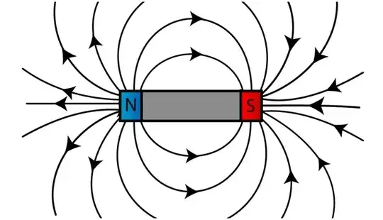

Following is the representation of magnetic field lines around a bar magnet.enter image description here
The lines drawn, indicate the direction of magnetic field lines. Now I want to know that is this a contour mapping of the original space that is present around a magnet. I mean can we plot this in 3d by considering these lines as contour lines of the original 3d graph.

No, the field lines are not contours.
Contours usually connect places of equal magnitude, height, for example, on a map of a hill.
The field lines on the diagram aren't connecting places of equal field strength, it's the gap between the lines that gives an indication of the field strength - the larger the gap between the lines, the weaker the field.

No. Contour lines depict scalar fields, whereas the information in a magnetic field cannot generally be represented in terms of a scalar field.
Contour lines are a way of representing a scalar field (in the context of cartography vertical elevation $h(x)$). A magnetic field is not a scalar field, but a vector field, and so does not have contours in a straightforward sense.
That said: certain vector fields can be described in terms of a scalar field, for example $\vec{v}(x) = \vec\nabla h(x)$ is a vector field that contains the same information as $h(x)$, and this $\vec{v}(x)$ could be visually depicted using contour lines (if you so wished). The magnetic field however is generally not such a field: in mathematical parlance, we say it is not a conservative field. (As noted in the comments) A notable exception to this is a magnetic dipole, such as a bar magnet, whose magnetic field can be described in terms of a scalar field whose contours run perpendicular to the field lines. This, however, is a special case.

No. But not because magnetic field lines are not contour lines - they kind of are.
In your case your 2d graphic is a 'slice' of a 3d case, so information is lost. If the magnet is a cylinder, then the 3d field could be radially symmetric about the rectangle given, and you could so reconstruct the 3d graph by rotation of the 2d 'slice' you have, and this would not be too unreasonable - but not actually correct.
